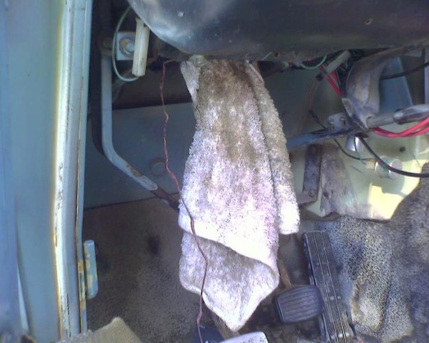

Scout died - need help on Saturday

A simple wiring harness on eBay (the 12 circuit variety) is under $100 - or was a few years back. I might get the 18 circuit one, to have spares. Painless stuff is just too expensive.

The spot that shorted should be obvious with some digging. I'd repair the problem and get back to pushing snow. The effort it would take to rewire the Scout probably isn't worth it.

That's my plan when I go up there tomorrow morning ;-)

In my experience, repairing a single wire is a LOT quicker and easier than replacing an entire harness. Whilst the latter can save potential issues down the road, the former is what I think we will need to do to get Tim's plow rig back plowing again in short order.
15,508
It lives. Culprit was a wire under the dash that wasn't connected to anything, that must have grounded out the other night. All of the insulation was burned off, over probably 18" of 18ga wire. So it got clipped off then taped up, also I disconnected the wiring for the original plow controller that I removed when it quit working, so in general we cleaned up a little wiring and it seems to be working fine.
As a bonus, Jeff showed me where my heater valve is, and I was able to experience heat inside the truck today for the first time. Drove it around in the driveway for about an hour, all seems well. Thanks again for your help, Jeff! :beer:
