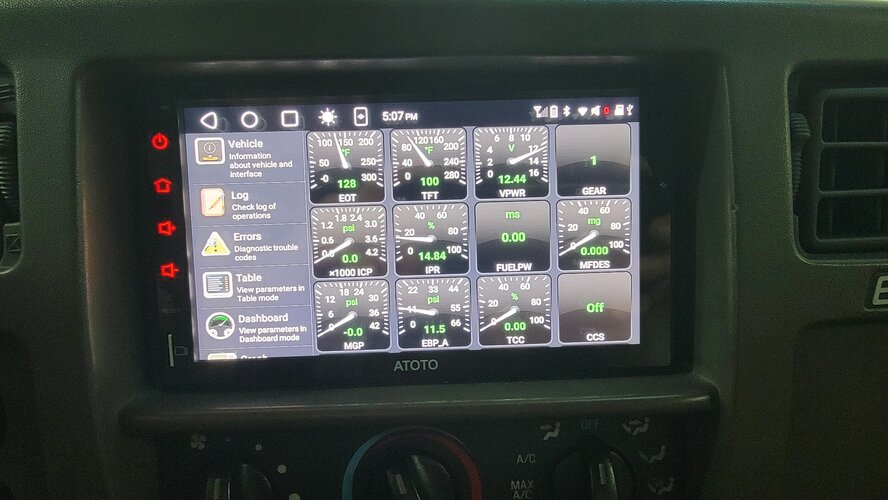

Monitoring: I run Forscan on an Android radio all the time, and so have instantaneous access to critical engine parameters. It looks like this:

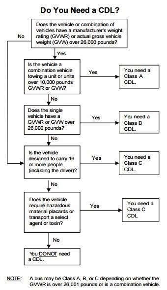

Does CO or UT require a non-commercial Class A or B for HEAVY Personal use?
Edit:
Just looked it up and CO/UT follow what Mike says in previous message. Thank you for the clarification, Mike, on Commercial vs Personal use.
