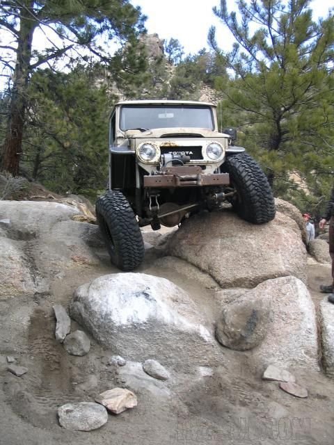

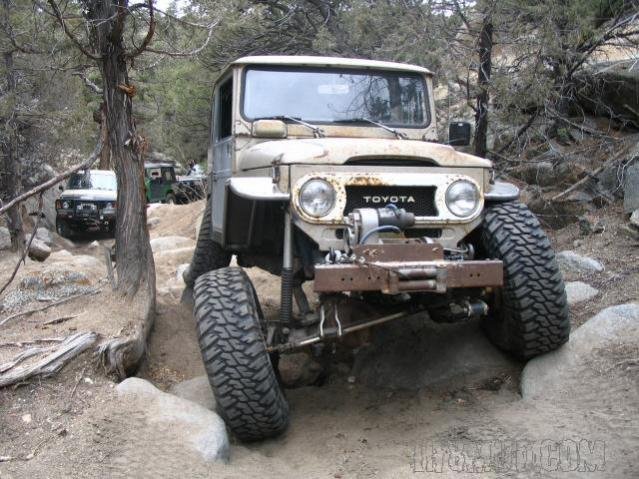

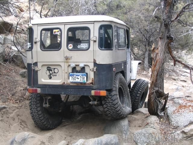

Shackle angle is the most important for ride quality. Mine rides like a Caddy with the shackles pointed forward. The downside is that you will destroy your springs at a rate of four per year. I went through the Northern 4" springs, I went through the 4" Downey springs, and I went through a combination of both to get a ride height that was about equal to stock. All four corners are sitting on the bump stops now. The go to guy used to be Alcan but I have heard from a few that that may not be true. If I were you, I would buy a set from Alcan as that used to be the best spring ever made and they are made right here in Colorado. Ask for military wrap, 4"+ springs with a touch more length that stock. You will settle, trust me, so the difference between 2 and 4 isn't even a debate. Run the piss out of them and swap them in a year for something else. If you do this to any leaf spring, it will break down.
