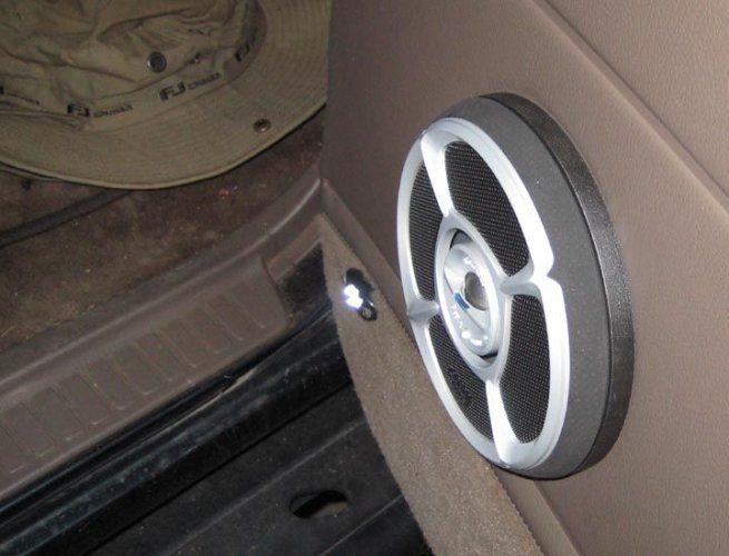

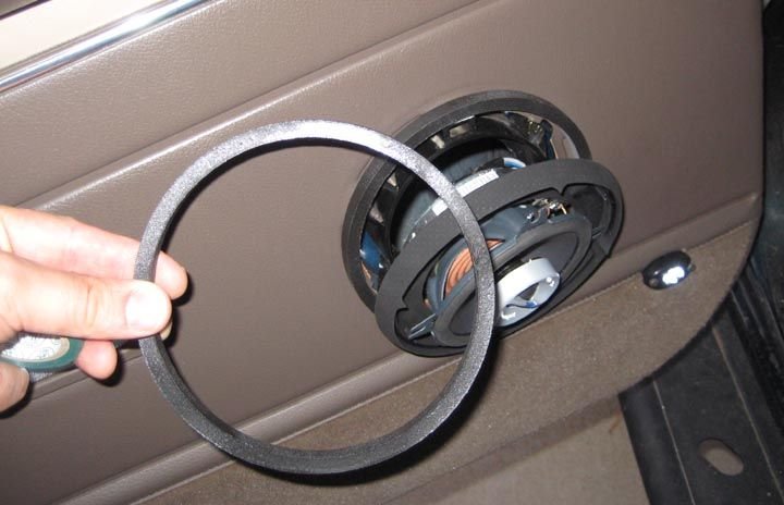

I got my spacers made up, they work just fine.. yes I'll run you a set. So my install is complete until I can get my hands on an LX grill, am hopeful they will work and it sounds like they will.
I don't have access to a 3D scanner. I'd like to get one, but the demand just hasn't been there to justify purchasing one. Maybe if we bought one and advertised it the business would come? I dunno.. but at this point I haven't been able to justify buying one. So I'd have to just measure away and draw one up from scratch if we needed to do replacement adapters.
We gotta get Martin to run the Ti though, we're not printing in metal yet... we've talked about getting a metal machine too and the Arcam like Martin has is the best one out there, but that would make 3 total in Colorado, which seems kind of excessive. Who knows maybe in a few more years demand will be up, problem is that machine is dang expensive to run so I definitely couldn't give junk away like I can do with the nylon sometimes.
I put more pictures up in the mud thread just to close the story there, but here are a couple of them...
Spacers look nice Tim :thumb:
Very slick. Definitely easier than getting the stock grill to work. A little black spray paint will hide the shiny stuff on the infinity grill and attract less attention.

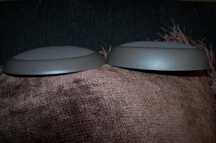

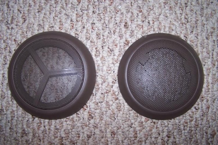

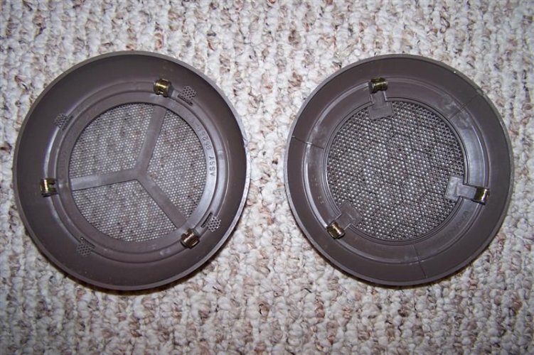

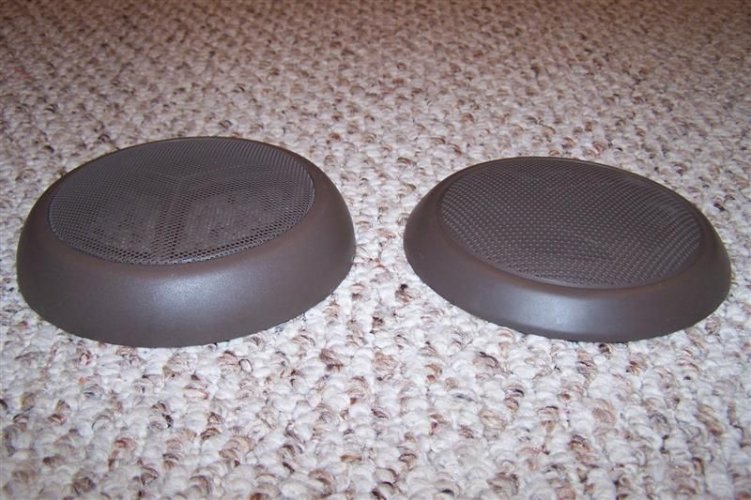

As promised, here are some pics of the grill off a '97 LX450 rear speaker and a '97 FZJ80 (AE for what it is worth) rear speaker.
The LX grill is on the left and the FZJ80 grill is on the right. As you can see there is a difference. About 3/8" difference in height to be exact. Diameter of each is almost identical (just a hair under 6") with the LX cover being about 1/8" to 3/16" wider.
Cosmetically the FZJ80 grill is 100% plastic while the LX grill is plastic but with an actual metal mesh cover.
For what it is worth, in looking at the front grills they look to be nearly identical -both fairly flat. The LX might have metal mesh on the fronts as well, didn't look that close...
