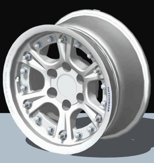

I ordered the Hutchinson rims. They have to be ordered to match the bead thickness of the tire you plan to run. The internal rubber insert has to be custom to seat both the inner and outer bead correctly. This insert is the beadlock. They are a 17" rim. The tires I ordered are the Toyo Open Country MT in a 35x12.5x17.
http://www.high-impact.net/wheels/hutchinson-tire_mounting_instructions.htm
http://www.rockmonsterwheels.com/products2.htm
size 17 x 8.5”
bolt pattern 6H – 139.7 mm BCD
lug style M14 shank nut (hub-piloted)
hub bore diameter 4.18” (106.2 mm)
SAE rated load 2,750 lbs. – 60 psi
backspacing 4.51” (114.5 mm)
construction Cast aluminum alloy

Thanks for the info. I looked at the web sites, a bit of a heavy rim, either 45 or 53 lbs depending on the model. But the internal bead lock is cool, that it will lock both beads not just one and it is DOT compliant as well.

The Staun internals also fit both of those criteria and weigh a whole bunch less!

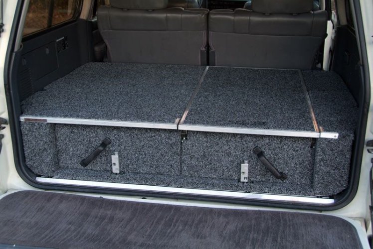

Worked on installing the AO drawer system at lunch today. The people I work with think I am crazy.

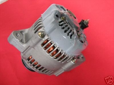

Anyone interested in a group buy on these? No deal just save on shipping a little.
170 AMP
http://cgi.ebay.com/ebaymotors/ws/e...m=200157872733&ssPageName=STRK:MEWA:IT&ih=010
Yes :D - Are these the same ones that are advertised over on MUD? - I asked about those and got some responses here but I don't know enough about alternators to make a very informed opinion. Bill posted up in the thread in MUD asking some specific questions but I don't believe there was ever a response.
14,144
Northside
I would be leerly of a stock cased rebuilt with that much advertised increase in output! The question is HOW! If it's just a bigger rectifier set and a smaller pulley then you will have one hot little puppy that I wouldn't count on! If it has a rewound armature in addition to higher duty cycle rectifier set and some way to increase air flow then I would say its a great deal!
