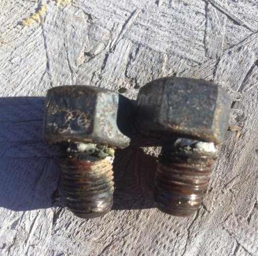

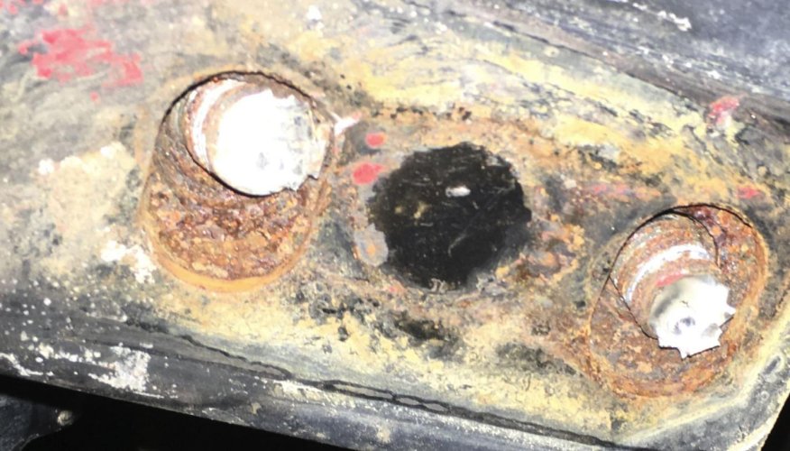

Not sure how you would weld a washer on the front one that appears to be bent
They don't stick out below the flush point. Looks like a lot of rust in there. Hitting it with PB Blaster

Try to fill the nut with weld, and transfer as much heat down the bolt as possible. The heat from the welding helps break the rust loose and helps out with the removal.

8,721
Drill it as close to center as you can and go up in bit size until you can retap them. You usually end up with a half moon of bolt and it falls out leaving the threads in tact.
X2 on this, along with the PB blaster (I use Liquid wrench, just as good in my experience). I also use left handed drill bits, they will often grab the remaining fastener and back it out saving time from retapping the female thread.

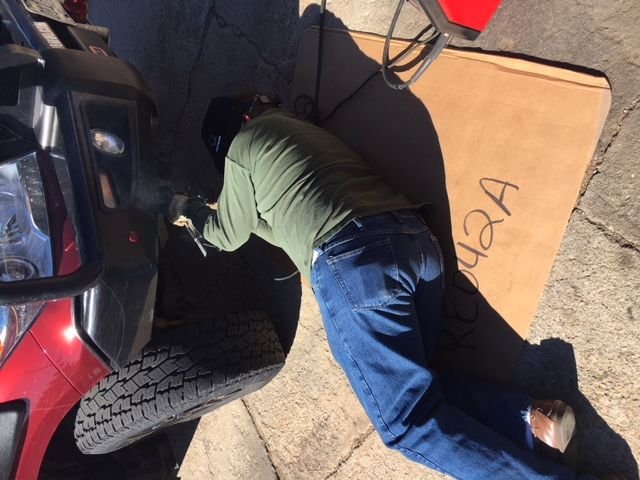

Thanks Kurt for the big assist today. THE BEST THING about this club is the people and Kurt helped me big time welding nuts on the broken bolts until the bolts came out
Now to get a 1.25 tap so I can put the new bolts in. One step at a time

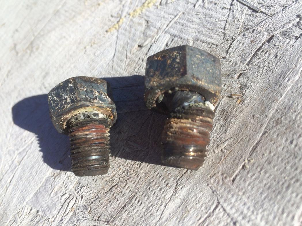

Thanks Ken!
The bolts threads I removed were pretty messed up. My guess is from the impact they took. Funny how wheeling it doesn't cause damage, but the parking lot does...There's a whole new level of danger when you use your truck as a grocery getter...

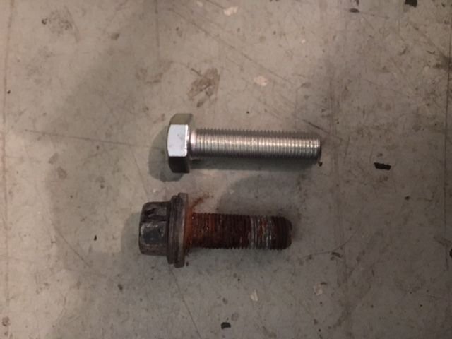

okay, found a 12M 1.25 tap at Advanced Autoparts in south Parker
Tapped the holes and put the new bolts in. Took the stock bolts out of the other one and found them to be significantly shorter (face palm)
It should have been obvious to use longer bolts with these thicker anchor points
I used M12 1.25 45MM 10.9 strength for the replacement bolts
I am all good now. Thanks again Kurt
