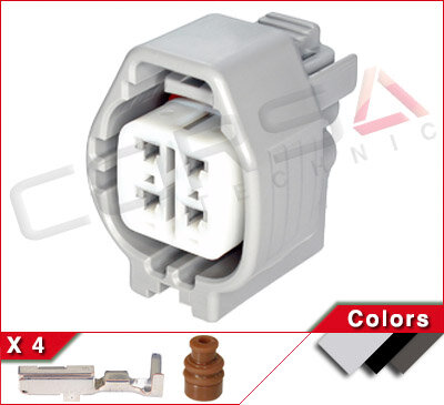

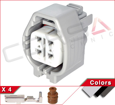

CORRECTION, the 1994 FZJ80 connector I believe actually looks like this:

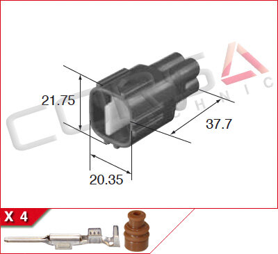

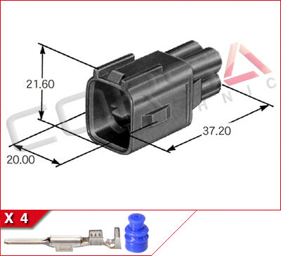

And that Toyota part is 90980–11178 (female) and 90980-11177 (male).
Screen Shot 2023-09-22 at 11.33.57 AM.pngScreen Shot 2023-09-22 at 11.37.30 AM.png
Pigtails:
For 90980-11178 is 82998-12440
For 90980-11177 is 82998-12430

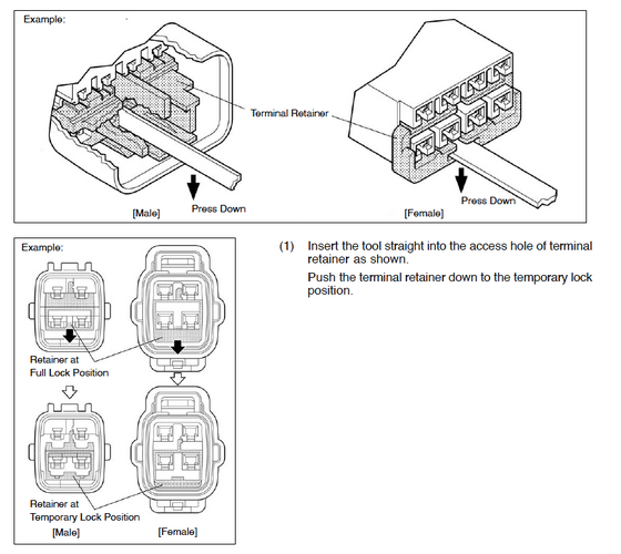

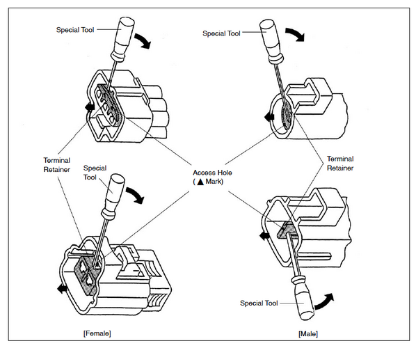

Make sure you unlock the connector, there's a retainer in the connector that has to pull forward (the red part in his video, but on these it's black or white in they grey connectors). This step is missed often and unless you do this the next step will not work.
Then you use the flat terminal tool to push up the ramp and the terminal will pull backward. The terminals can be released from the connector with a very small, flat tool. A small jeweler's screwdriver might work if you're careful.
To install you push the terminal and seal in from the back until it clicks. Repeat for all four and then push the retainer back in to lock all the pins.
Here's a few of the graphics that are specific to the Yakazi types Toyota uses as to how the retainer locks should be released. How you do it depends and I'm not sure which is right on this one exactly.

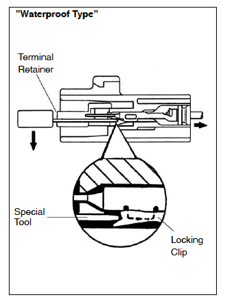

A side view of releasing the tab on the terminal itself.

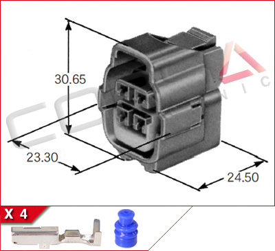

I don't have a complete FSM for the 80 series to reference and when I went back on notes for what I used on my truck (2008 Tacoma) it uses a 90980–11028 and mates to 90980–11027. The Toyota pigtails (82998-12440/-12430) are the same.
These are also 4-way and are very similar. The difference is small but if you look closely these have different kind of guide slots on the side and bottom. It's more obvious on the female side.
This really only matters if you're matching one to the other. If you're replacing both it wouldn't matter.
These are the Sumitomo kits (Toyota uses both Sumitomo and Yakazi as OEMs).
90980-11027
https://www.corsa-technic.com/item.php?item_id=984
90980-11028
https://www.corsa-technic.com/item.php?item_id=746
