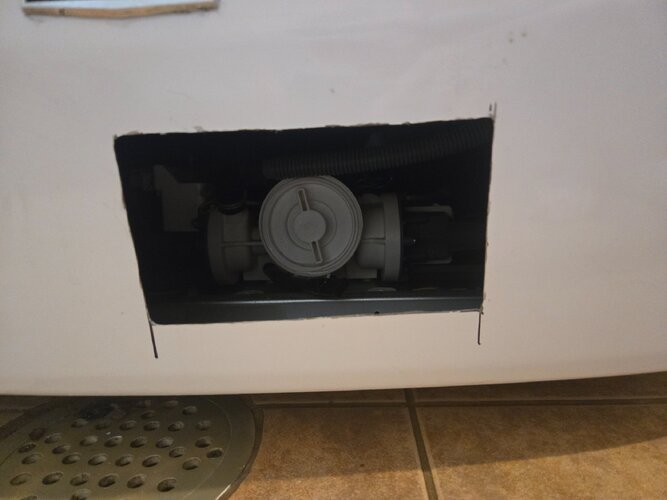

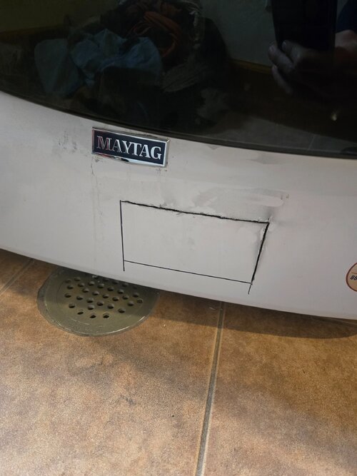

This last weekend we got an error code for a clogged filter. Well our washing machine did not appear to have a user serviceable filter... or did it.....
I opened up the back. Easy enough, 15 min. Then I saw that the pump and filter are at the front of the machine....
Maytags service procedure involves removing the top of the machine to start. Then the control panel, the front load door, the gasket and spring retainer, then the entire front of the machine. Not only is this a stupid design, but we have front loading machines with a nice shelf for folding clothes attached to the top with VHB tape, so its impractical to disassemble the machine for service. With dogs we also need to clean the filter more often, it was absolutely full of pet hair.
Enter Mr. Dremel who solved the problem! Now we have super easy access to clean this thing monthly. A friend is going to 3D print a cover for it so it looks good. I also need to grab about 6" of hose so I can extend the washer pump drain hose directly into the floor drain.

Jeff I kept thinking there was an easier way for this one but no dice. Its a really dumb design. I actually got the inspiration to cut from a reddit thread where a dozen others had done the same thing.

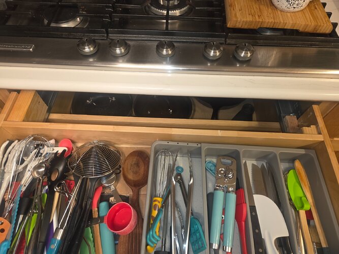

Cabinet guy said we had two options for the top drawer under our gas range. We could not keep it as a drawer due to the gas regulator sticking into the space the drawer would need to close. So his options were a flip out with little wood pocket to hold a few small items or a simple dummy drawer that was glued a and screwed to the cabinet face. This seems silly so I said just mount the drawer and I would deal with it. My mod lost us a few inches, and if I had the time and tools I would have just boxed out a small area and gained a little more space. Instead, I hit the easy button and moved the back of the drawer closer to the front with just enough room to stop before it made contact. Easy peasy, lemon squeezy!
I still need to slightly modify the 2x4 pieces i added foe the back of the drawer to grab the slides, but I'm 98% there.
