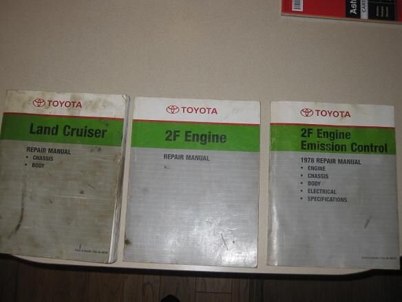

I have a set of factory manuals for 1978 fj40. They are a little dirty. Make me an offer. PM me.

PM me with your address and I'll stick them in the mail. Did you need all 3 or just engine and emission?
