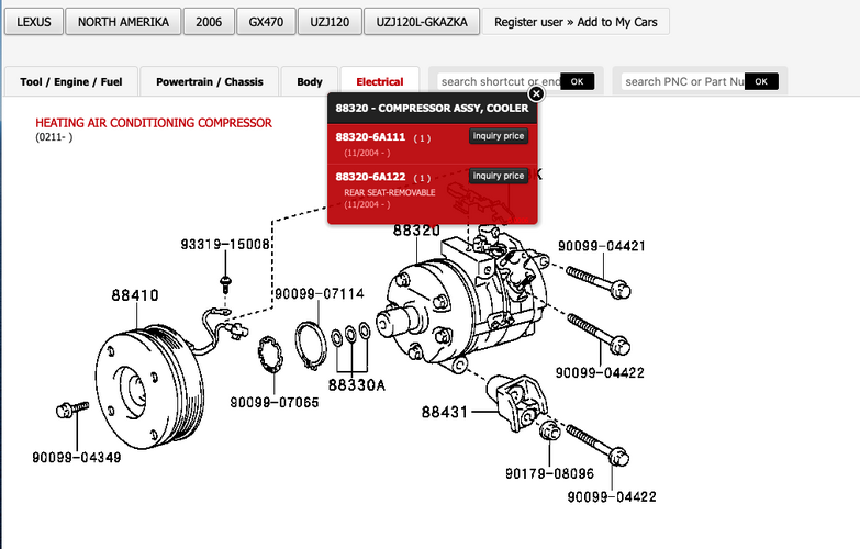

There are two compressor options.
88320-6A111
88320-6A122
