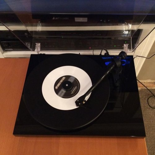

Purchased the Pro-Ject Debut Carbon DC yesterday. Works great, easy to set up. Listened to a Jeff Tweedy 45 on white vinyl that had never been played.

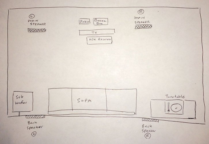

I have a question about hooking up speakers to more than one receiver. Right now, I have my old HK AVR30 receiver located beneath our TV. I have a center channel speaker, 2 front speakers, 2 rear speakers, and a subwoofer -- and all of these run to the receiver. (see diagram)
My problem is that I don't have a good place to put my turntable with this setup. I do have another good location in the back of the room (see diagram). I know that I can't extend the phono output 20 feet to connect to my receiver. One solution would be to relocate the receiver to put it with the turntable, and then connect the speakers from there.
I could extend the output from the TV through the crawl space all the way over to the receiver, but it wouldn't be ideal for several reasons. For example, the remote control wouldn't work to be able to adjust the volume if I move the receiver to a spot that has no LOS.
I'm thinking I could buy a newer A/V receiver to use with the TV/DVD/Roku/Boxee Box, so I could use my old HK receiver with the turntable. Here's the issue: I'd prefer to use the same speakers for both receivers. But I am guessing that if you hook two amplifiers to one set of speakers, the amplifier putting out a signal will drive that signal back into the other amp, potentially damaging one or both.
I did find this box, the Niles Audio DPS-1, but a) it would probably run only the front speakers (no subwoofer), and b) it's $100, which is spendy.
Any ideas?

I'm not Dave, but I am an electronics engineer with 3 decades of experience, and in particular a lot of audio, both home and pro.
(1) Phono preamps are inexpensive and would work fine to extend your phono signal to your receiver. You'd then have line level which would be good for many dozens of feet without any noticeable degradation. If you wanted to go further you could either go balanced low impedance or even digitize but that would be way overkill for this application.
(2) Never EVER connect the outputs of two amplifiers together, BAD JUJU. It would make the magic smoke (tech term). You need to switch them with a dual SPDT with the commons to the speakers and the inputs to your amps.
