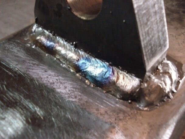

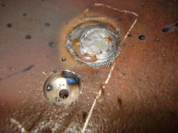

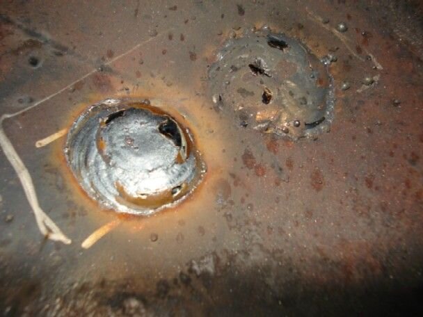

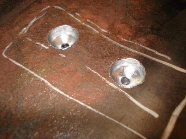

Well, I got to finish the fab on my bumper today. I took everyone's advice and opened up the rear of the bumper with a pilot hole then I opened up the base metal even more to fill them with weld.
I was actually really impressed with how much heat and wire it soaked up as I filled the pilot hole. In the second pic, I stopped to snap a pic, then I started to perform a "rose, plug, rosette" weld around the edge of the bigger whole to work it into the base material more. In the end, the welds looked like an "8." All in all, I was shocked at how much heat I was able to get into the weld.
You can see how much HAF I had on the front of the bumper. I appreciate everyone's help and advice, I feel better tuggin' on these mounts now.

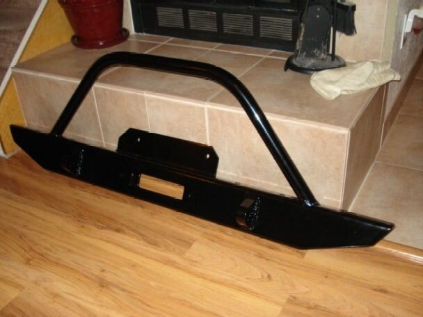

Back from powder coat! :hill: :hill:
What a great job my buddy did, he was worried because he saw little imperfections in the powder coat, but in reality it was just a little pitting from the surface rust I couldn't sand out. :mad:
I think it came out great! :thumb:

8,905
in da house
yeah, you won't see that once it's covered in mag chloride.. I mean mud ;)
Looks good :thumb:

Looks great man!!!
I thought it might be a case of self criticism rather than actually bad.
I know that all too well.

Bumpers looking good Drew!:thumb::beer:

Thanks guys for all the nice words. :thumb:
I was starting to think the hoop was too high, but with the lights it looks "right"
I had a glitch tonight trying to get it on, I forgot to mark which winch wire (say that 3x fast) and I went with my gut, and might have gotten it wrong. Gotta' actually look at the wiring tomorrow and button it up! :D
