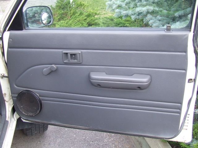

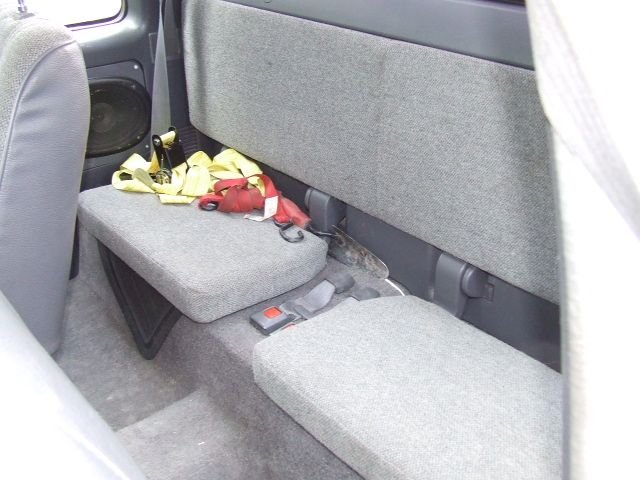

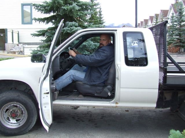

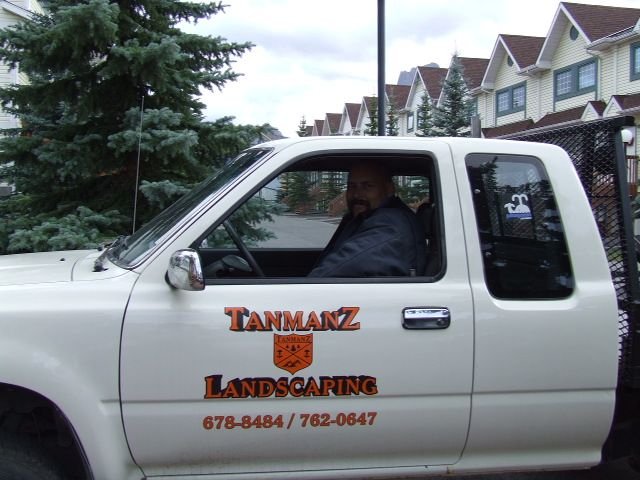

more pic's
Thats it....it's over! (Hey what do you expect from a mini rage?):rolleyes:
If your smaller then they're fine. Sitting in a 1-3 Gen reminds me of airline seating! :rolleyes:[/quote
See i do fit..

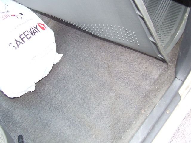

a few more

Very nice, looks to be well cared-for.

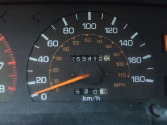

btw dude, your speedometer is backwards- the MPH goes on the outside. :)

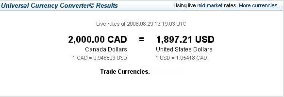

Not much difference these days! :(
