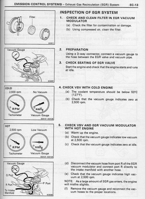

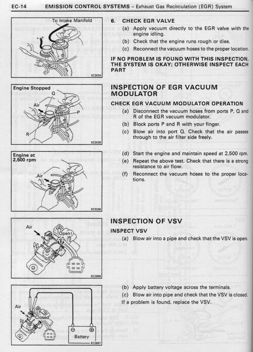

Please keep us posted Crash, as I suspect EGR related malfunction is plaguing my 3FE...
TJ, the EGR tests are very simple to perform. Do you have an FSM? If not I "think" I can scan the tests and email them to you.
14,135
Here's the one from the 22R-E and 3VZ-FE to give you some reference. It's not tough and probably similar on the 3FE.
4,627
The 77exhaustq notes are very similar to the 3FE notes, just drop the 3,500 rpm test number to 2,500 for the 3FE.

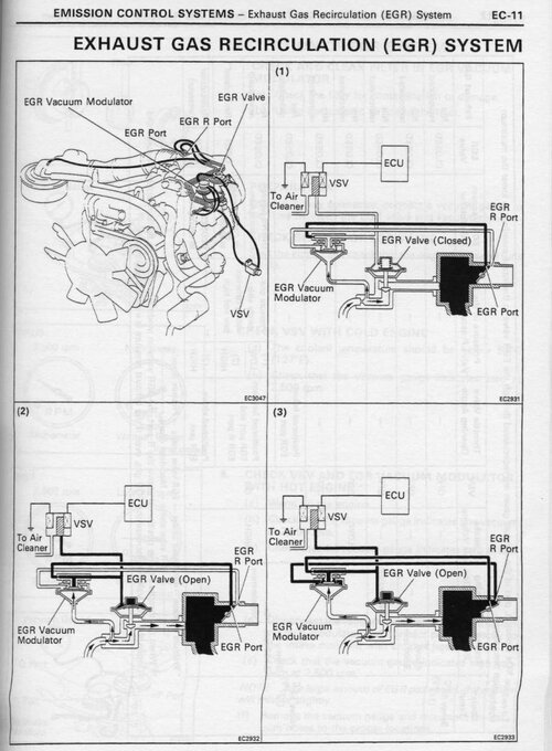

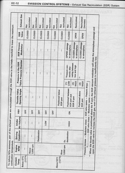

Thank you guys again for the help, here are some scans for 3FE EGR test from the '88 FSM if any future searchers come looking to lower their NOx...
My vac modulator caused the vac gauge to creep off 0 ever so slightly when engine cold @ 2500 RPM. I will replace, but I am wondering if this could cause loss of idle when hot...
I need to start a new thread on my 3FE.
