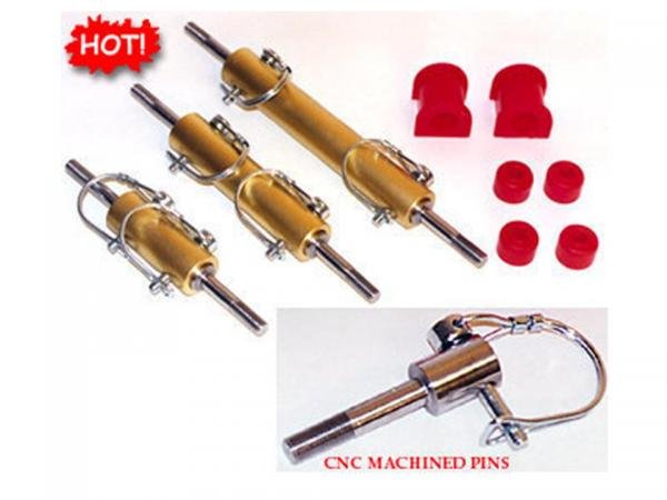

Let me know when you need the disconnects. This is what I have (the long ones):
Red_Chili
8,335
Littleton CO
Can you bring them to the meeting? THANK YOU Randy!
Looks like, if I need them longer, making longer center tubes is no big deal (drilling very carefully to align things though). Roger just disconnects one side of the rear swaybar, but I don't know what its flopping around might hang up on, if anything. I will have to investigate. Rubber bungees are a simple solution.
