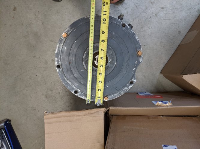

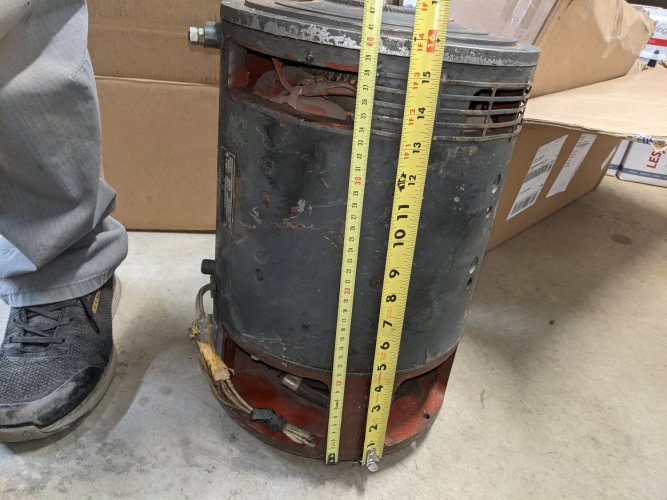

What are the dimensions of the motor, and can you post some other pics of it to get an idea of how to hold it?
It is approximately 11 in diameter, 17 inches long. It's just a big cylinder. I attached some more photos, I can get more tomorrow.
Need to machine clearance for a typical front CV axle. I can get exact dimensions tomorrow.
