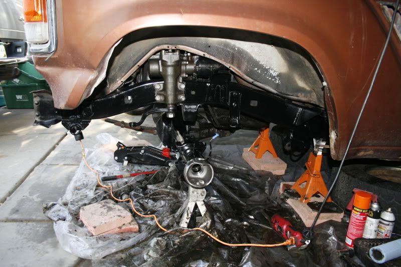

What are the larger seals for? Listed as #9 in the picture. I don't think I've run across those yet. I really should get an FSM.
Heres the progress as of a couple nights ago.
9,705
#9
They look like the big ones that go in the hub after you drop the inner wheel bearing in.
you really got that thing clean.. take a look at that steering box!

that is clean. Elliot did you just use up the free worlds supply of brake cleaner?

Thanks for the heads up, that must be where that thing goes. I'll be separating the hub/rotor and reinstalling everything this afternoon so I'm sure I'll find a home for it somewhere.
