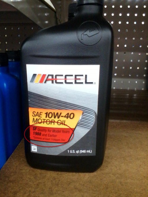

Now, with more zinc....
Thread resurrection again. The 10w-40 Accel oil bottle at Walmart has been revised again and now says 'Contains at least 1100ppm Zinc'. Still $2.67/quart.

The Evergreen Walmart doesn't even sell quarts any more, they've gone to the big jugs.
