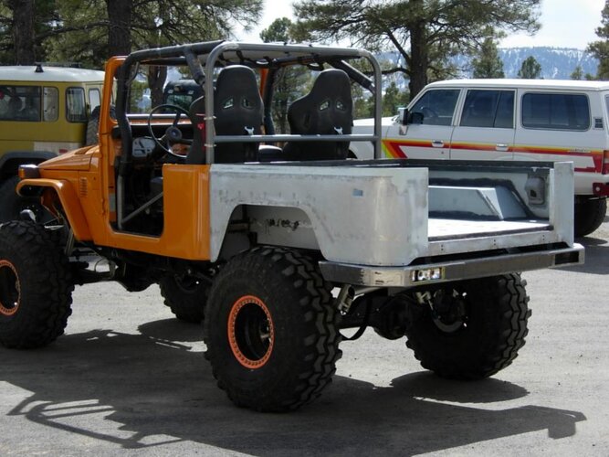

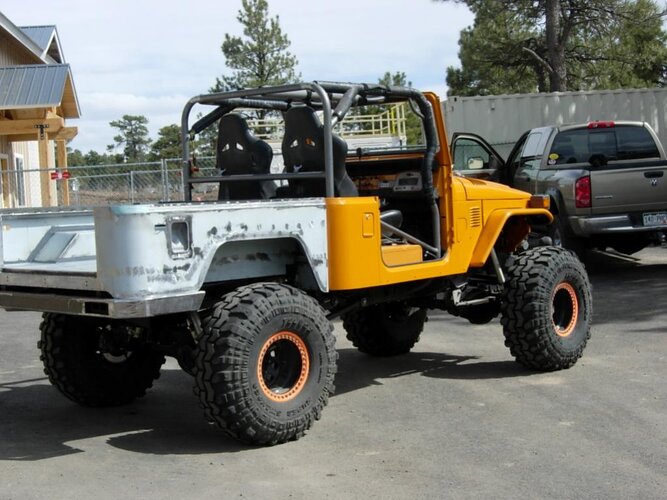

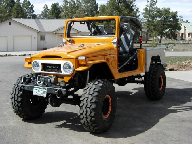

AWESOME!!!!!!!!!!!! Top notch work man! I'm WAY impressed.
5,462

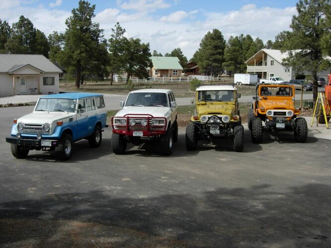

That's quite a lineup there. Very nice!

Enough to make even a minitruck guy drool! :lmao:

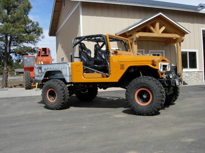

Hey Mike....Who did you use to make your top? Did you make a frame or us some factory parts? I have a Paki top for a 45 but do not want to use the factory frame stuff. i want a top that can come off quick and the factory stuff takes longer to remove than the hardtop.
Great job by the way..

Wow, really impressive.:thumb:

Thanks guys.
Gary,
I made the bows from 3/4".095 tubing. The bows are welded, 1 piece set up. The rear window zips from the top so you don't have to remove it, but can if you want. With the rear zipped down and the doors off its like having a bikini top. My idea was to have the top and bows come off in 1 peice, but should have consulted with the upholsterer first as it ALMOST came out how i wanted. The top and bows together probably weigh 20-25lbs.
Oh, i used a Jarod Marx in Vallecito Lake. He does all of our customers rigs.
(The next one i will use heavier material for the soft top).
With your skills i would make it a removable 1 piece w/quick disconnects. bling bling.
Mike
