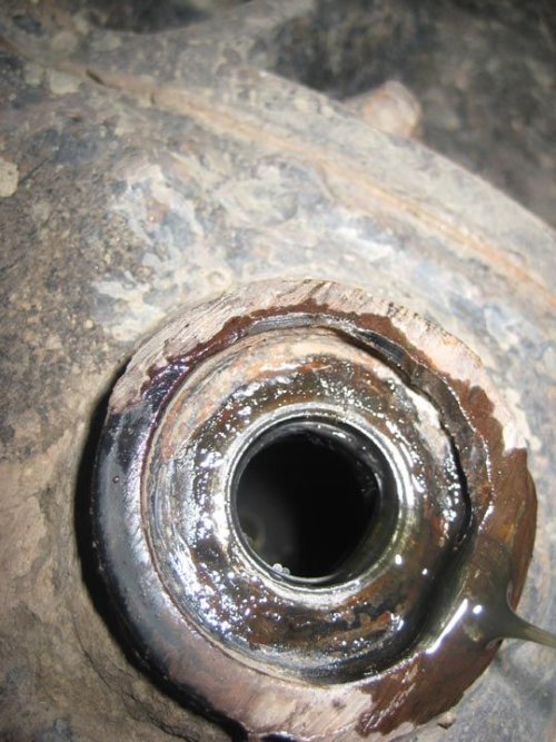

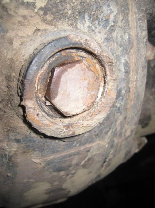

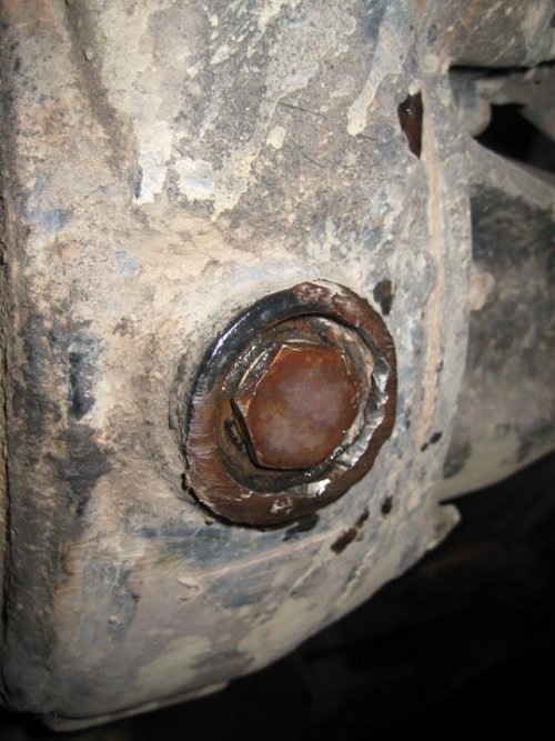

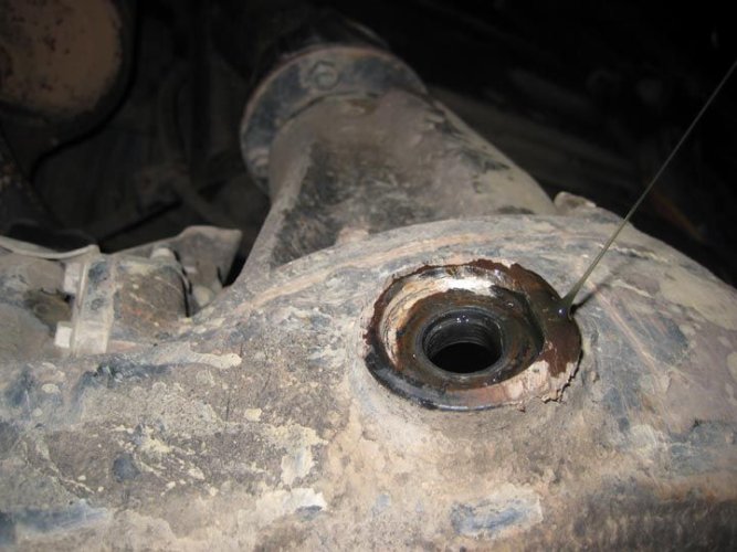

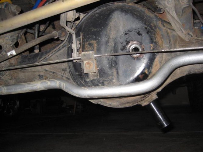

Hey, that chisel was the shizzle! :hill: In fact it ended up being the tool that loosened the drain bolt. Not the prettiest job in the world, but effective.. was tempting to just leave that 24 slammed in there... :rolleyes:
Pics should tell the story... thanks again folks. :beer2:

Dude your lube is defying gravity! :p:

You protection ring is ground down like mine was. Your gonna keep having problems until you weld another ring on there.
Yeah but if I get the allen head it will just self-clearance on the way out, right? Unless I really bugger it up again.. :o
You will be able to get it out with the allen head, so that problem will be fixed. But, it will grind down on the rocks more and work sideways and strip out on the trail. It happened to me several times (and Chili on Chinamans-he lost his fluid) until we beefed up the protection ring.
Yeppers. The allen is just as vulnerable as the hex, just somewhat easier to get out (unless you REALLY buggered it).
You need a CHILI RING. Hoooah. You know you want one.
It was Chinaman's that inspired it.
