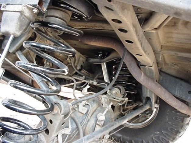

Moved the mount inwards a little and all is good. Any shock bigger than the Bilstein 2" will probably hit the sides and need the hole enlarged.

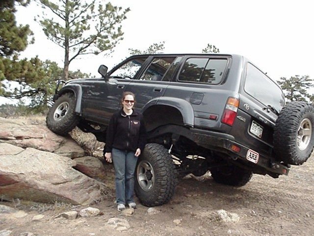

Worked pretty good this weekend up at kelly flats, and I'm slightly unseating at full droop, so it will need to be retained.
1st Pic: posuer rock, TJ's lil' Sister standing in front, yes she's taller than 5' :)
2nd Pic: looking under the body...
