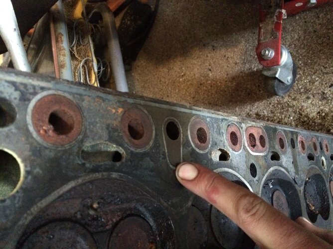

My recently aquired 6/73 fj55 has a bad head gasket so I dug into it this weekend. The truck came with a redone head that is casting 60051. The truck has a casting number 60050 head on it that I removed. They apear to be the same. I ordered a felpro head gasket kit through rock auto and the head gasket is slightly different in that it has the tear drop shaped cut out towards the back of the motor. The F155 has the copper tube oiler. My question is can the 60051 be ran(apears to fit) and does it matter that the tear drop shape is there in the head gasket? Thanks!

This is the tear drop. From a later head.

Thanks again. Can you shed light in the casting differences?
8,686
no clue on casting. this is what's in the parts catalog for the cylinder head sub assy
11101-60071 (03/1969 - 08/1969)
11101-60072 (09/1969 - 02/1972)
11101-60074 (04/1972 - 08/1972)
11101-60090 (09/1972 - 08/1973)
11101-60091 (09/1973 - 12/1974)
