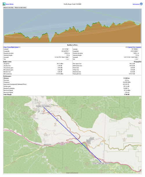

So just an update to my latest purchase of the Yaesu FTM-3100 I installed a few months back. I finally got use it in the wild yesterday on the snow run. Just some general specs on this radio, it is a 2m single band with three different power settings. Low-5 watts, med-30, and high-65 watts. I use this radio with my mag mount diamond antenna that's good up to 70 watts of power.
While trying to meet the snow run group at the parking area just above the central city cemetery I ran into the heavy ski traffic on I-70. I tried numerous times to reach someone who might be listening as I was headed up the hill. I had the radio set at the highest output setting at 65 watts.
I was finally able to get a hold of Perry who was at the parking area and I was near the Homestead overpass by clear creek high school.
I was able to hear Perry really clear and he was able to hear me clearly which was pretty awesome. So as the crow flies it was a little over 9 miles.
Not sure if this is great or not but I was pretty happy to get decent distance on simplex.

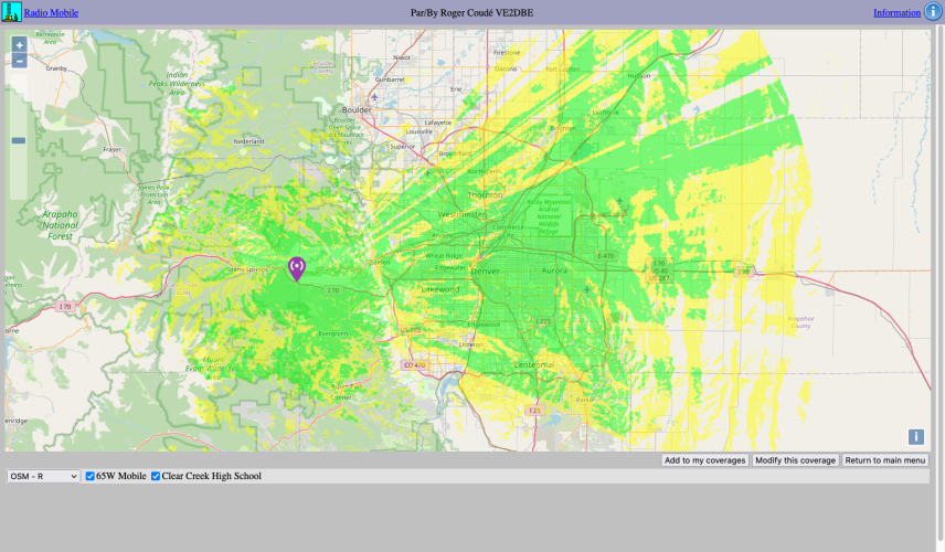

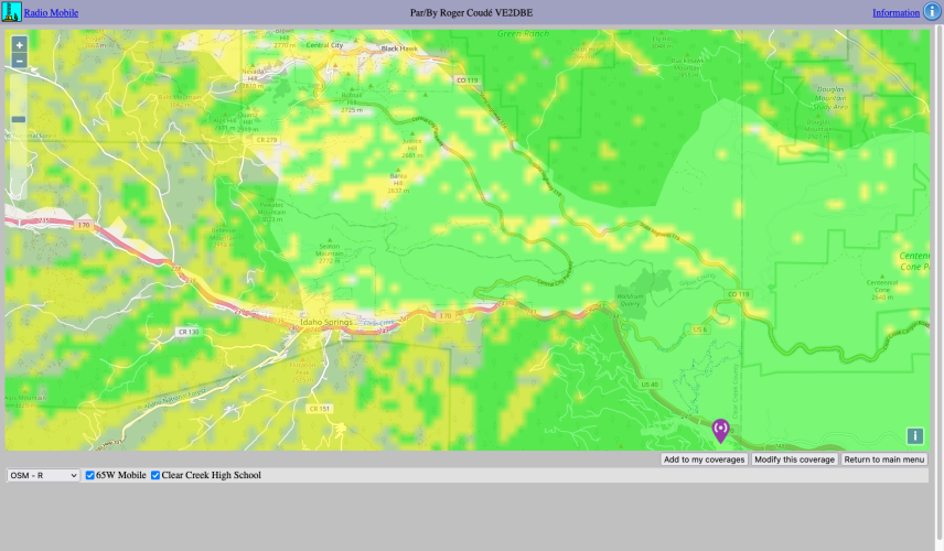

For simplex that is about as good as you can expect.
Generated coverage maps using 65 watts with a 3 dB antenna gain at 2 meters over ground.
To be technically complete - green is strong, yellow is weak with the threshold being 10 dB lower. Minimum received strength is 0.5 μV (-113 dBm RSSI).
Point being the link you and Perry had was right at the limit given power, antenna height and terrain.

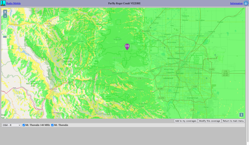

FYI. Compare your simplex link and coverage to what it would look like talking to a repeater. In this case I approximated the Colorado Connection repeater on Mt. Thorodin not too far north of Central City, using the same power, antenna and reception thresholds (e.g. like putting your truck 100 feet up on a tower atop even a fairly low peak). Height is everything!

Yeah, I just took a couple of prominent landmarks. I can run an exact analysis if you have more detailed positions. Your local position isn't really limiting it, though, it's all the peaks and valleys in the path cumulatively affecting line of sight. There's a concept called radio horizon, which is actually just beyond the visual horizon. IOW RF wraps around objects and land slightly, which is why this path likely worked. You can see a similar thing with the Sun, which even when it's below the horizon still gives us light for a while at dawn and dusk.
