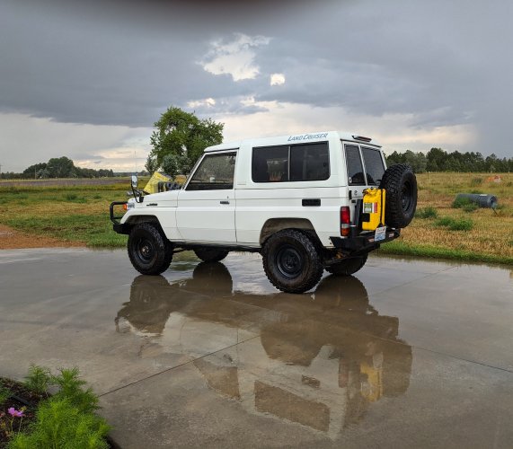

Hamheads: what antennas are you running for off-road use? I’m going to be installing a Yaesu FTM-400XDR in my 200 Series, and will likely place the antenna on the ARB bumper tab. On my 73, I have a bumper-mounted antenna that, while it works well, it also jiggles like crazy, and can be annoying in certain situations.
For the 200, I’m looking for something that is powerful enough for convoys, and rigid and short, so it isn’t wiggling in my line of sight. What might you recommend?
