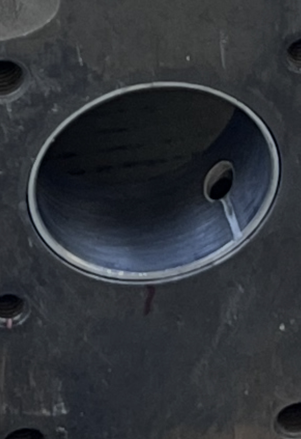

in da house
I forgot about my cam bearings. I don’t have really any pics but I zoomed in on this one. It looks scotchbrited and has a score. The tool must be old or something… not sure why they have so much trouble with them
Before Xmas I took my fly wheel to Doug to turn. He did a great job and noted the step when I bought it in and had it in a day or two. Not sure how long he takes for full machine on a block and head.
Definitely worked the surface a bit. That score to the oil hole is correct and should be there.
8,938
in da house
Thx, I don’t remember what they were supposed to look like. I thought it was just the holes but it was a year and half ago
