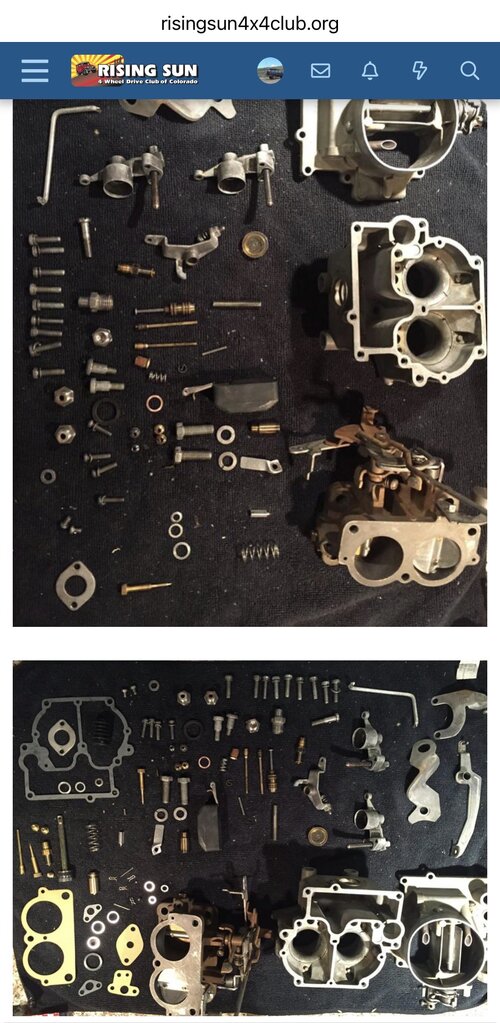

this thread reminds me of this picture from here:
[EMBED content="post-310565"]https://risingsun4x4club.org/xf/threads/1969-fj40-hot-mess-to-minty-fresh-or-spring-green-fresh.26357/#post-310565[/EMBED]
it fits so nicely with my ocd
