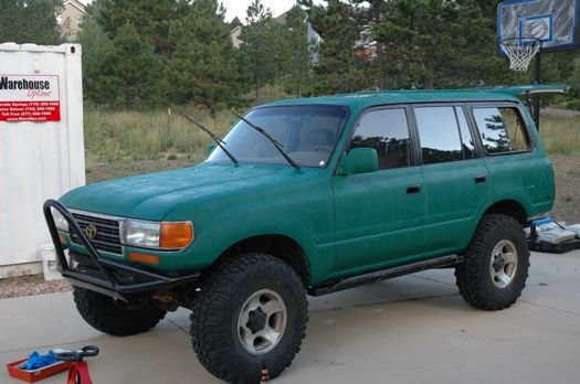

Here it is with two coats...
"It ain't easy being green..."

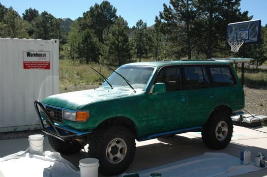

This is the mess that one coat makes....

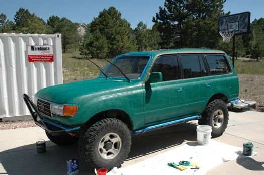

Terrible lighting for the finished shot...
Electrical tape for prep is key around the trim and gaskets, you pull it and it cuts the Durabak in a line like a knife. Extra "blue" paint tape was a mess to remove, you'd just bury it if that's all you used.
I'll be painting my trimmed rear quarters - they are subject to the occasional bit of bumper abuse (despite my "hockey puck cut in half in an angle between the frame brace and reinforced cut panel that works like a charm design :hill:) and rather than deal with potential Durabak peel spreading like a disease I'm just gonna paint 'em.
Pass the salsa :D

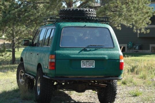

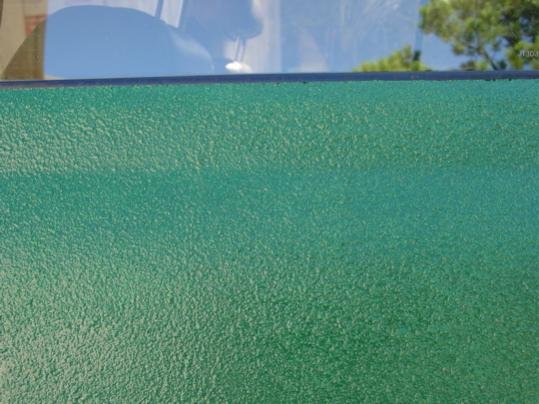

Here's a couple of pics of the finished look, it darkened as it cures, but I am finding my camera likes to overexpose the pics in full sun.
General public response has been, in the words of two firemen who came up to talk to me at the gas station yesterday, "that is just badass :D".
Not a good mod if you don't want public attention ;)
