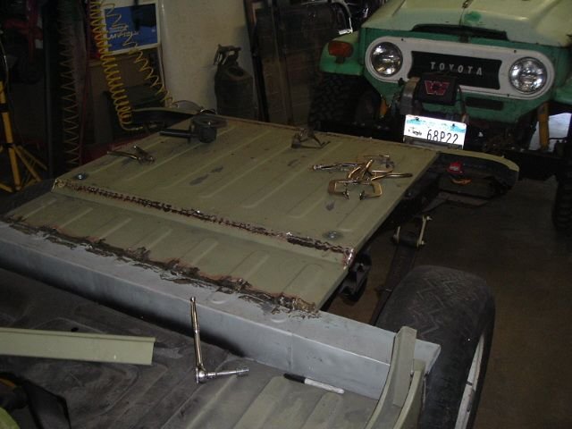

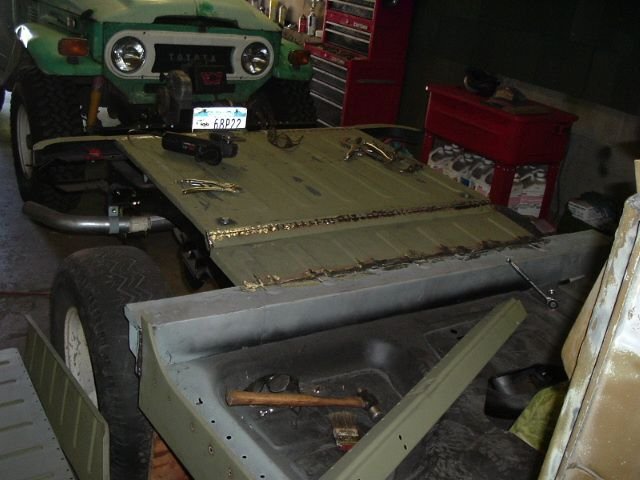

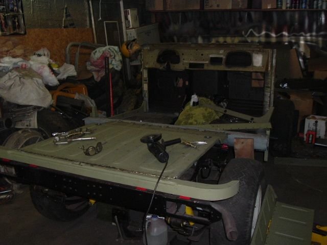

Page 28 was updated over 4th of July weekend...the photos below are from yesterday. As you can see, I'm a lot further along. Later today I expect to start on the rear quarter panels and wheel wells!
