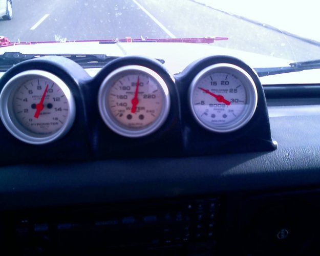

egt's are a little high but overall it runs good. I'm just going to bag the boost controller and probably not hook up the wastegate. :hill:

OMG.. I could have done a bad thing. I got a custom 2 1/2" straight exhaust with no wastegate and now I'm boosting up to 25psi :eek: The work scott did at AA on broadway is exactly what I wanted. 90* mandrel off the flange and routed inside the frame rail next to the t-case. No muffler. I think my previous set up which was a literal 90 out and down probably restricted my flow to such a degree I was only getting maybe 15. Once it opened up to a free flow I got me some major boost. I gotta adjust the fuel but I make 10-15psi like it's nothing :D
There will be no passing me until I bend some crank rods :o
I gotta look at blow off valves or something
