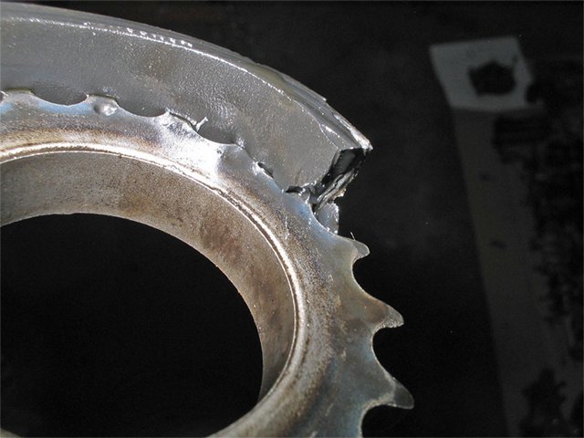

  • Timing chain blew open in 2007 at ~145K. The tension side guide snapped and jammed in the crank gear.

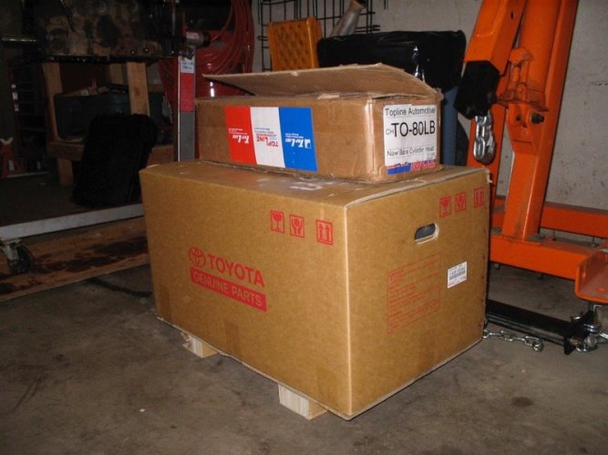

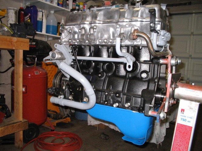

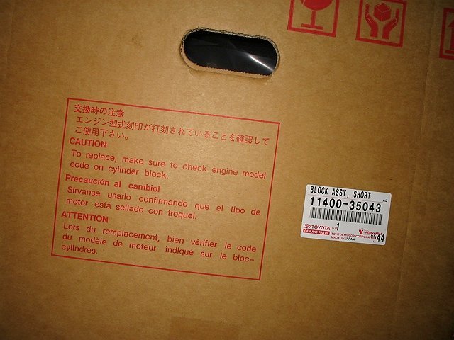

  • Flush with money so more dollars and sense... I ended up putting a brand new Engnbldr head (Topline casting, oversized valves, 231C cam) on top of a brand new (literally zero miles, from Japan, in a box) factory short block, headgasket, timing gears, chain, tensioner, head bolts, water pump, oil pump, clutch, release bearing (everything Toyota came from Jerry at Burt Toyota).
  • The rocker assembly was all new parts from L.C. Engineering.
  • If I remember right it got a new Performance Radiator. It was a brass one but not Toyota. I reused all the emissions crap. I had the intake plenum hot tanked to clean it out. Witchdoctor cleaned the injectors.
  • I think I got an overbored throttle body to match the head. You can tell if the throat is smooth all the way through and no step.
