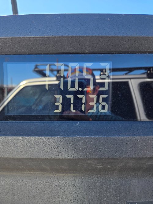

I bought some ethanol free today.....
Owch....
