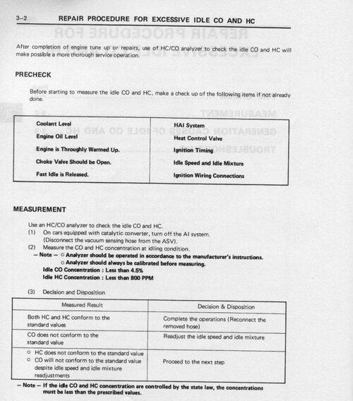

Here are the details from my '78 Toyota Emissions Manual:
They go for timing first, then vacuum, then mix, then things like air filter and PCV...
