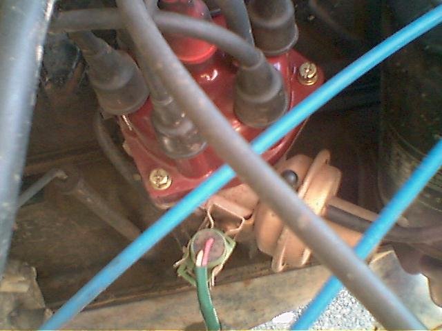

Ok, it is monday...so I just want to double check...here is a pic of my dizzy, My engine is a 78, so wondering if you can tell from the pic what year it is?

Yes, that looks just like the one in my 78.
