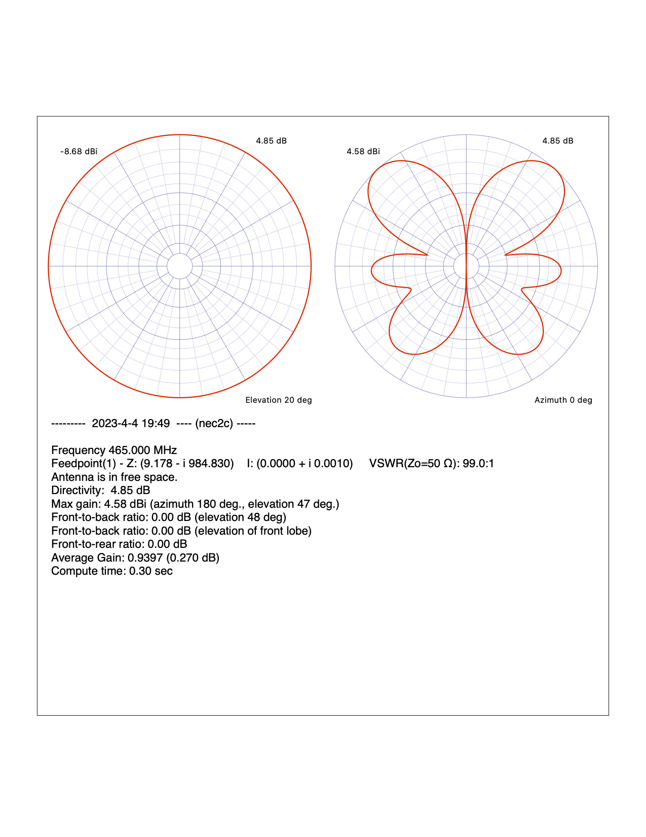

Those 32" antennas are 5/8 wavelength stacked elements. What it looks like mounted with no ground plane. Main lobe occurs at 47°.
Same over a ideal ground, pattern more typical if on a roof. Main lobe is 55°.

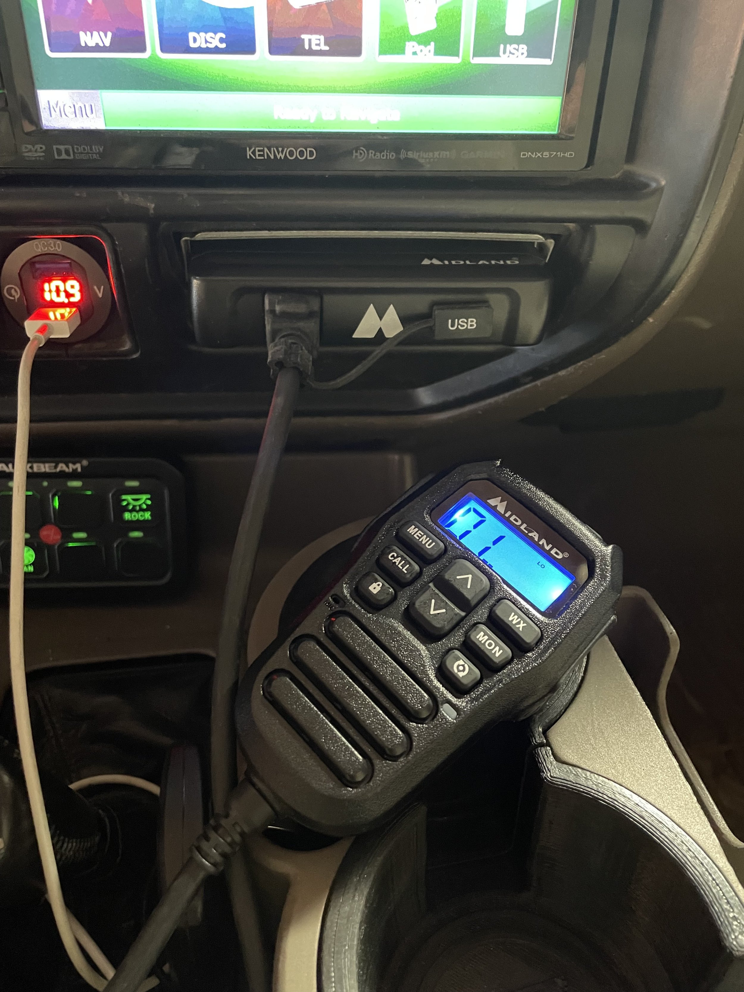

I just did this with one of those ghost antennas.
Haven’t had a chance to use it yet.
