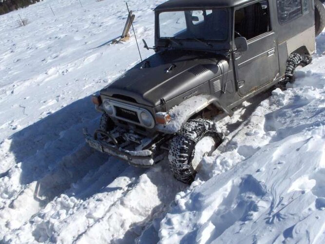

It's fun seeing the changes - this is what it looked like last winter - major cosmetic changes are diamond plate, fiberglass cap, front bumper (bashed in by Cruise Moab :D), bezel painted better w/clearcoat.

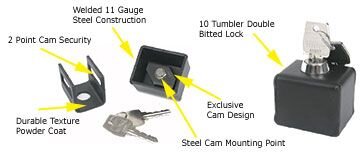

Might as well continue in this thread: you guys running 8274 or similar (front mount): Are there any good ways of securing your winch so nobody can steal it? I've heard stories. All you really have to do is remove the fairlead (pretty easy) and take four bolts off and you're home free with mine. Or is this not common enough to worry about?
Red_Chili
8,335
Littleton CO
You can weld a cap over one or more bolt heads. They need a grinder to steal it then.
corsair23
Jul 11, 2006
8,610
When my 8274 was on my '76 the PO had spot welded (edit: I guess it is called "tack" welded :)) the two upper bolts to the bumper. Definite theft deterrant but it also made it a huge PITA to get the winch off when I went to do so. Of course they could just steal the whole bumper with winch attached :rolleyes:
Anyway, I went with one of these when I moved the 8274 to the '74:
http://www.tuffyproducts.com/door/104.html
Got it from SOR way back when...Not sure who might carry them locally. Should deter the lazy thief, not sure if it would deter a determined thief though :confused:.

I use that little box thing over the bolt. My winch hasn't left my rig yet.

If your worried you can easily just tack weld the bolt heads down too. Fairly easy to grind and free but not without making some noise!

Welding the bolts is a bad idea from what I understand. Heat is bad for the strength of the bolts. Better to weld a c-channel piece over one of the heads. If someone is willing to steal your winch they'd just steal you truck.

The bolts in the 8274 are in compression when the winch is in use, so I'm not too concerned about that. I like the idea of welding a washer or something round on the head...anyone willing to help me with that? Probably be next week...
