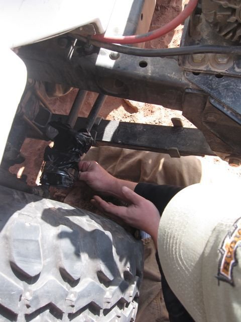

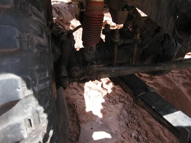

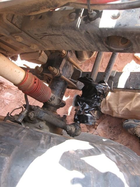

Details on the trail fix? Did the break happen on that first rock ledge after the creek crosssing?
Nope after that above the switch backs. I was backing up fairly straight and pop goes the tierod. Those tierods have been in place for 13 years driving those same trails. So I will replace all the tie rods and keep a couple of spares on the truck.
Once we hammered out the broken piece, if we had a replacement it would have back in action within 5 minutes.
Fix: Placed the remaining stub back in position, place a d-ring where the two rods meet next to the tie-rod end, used a band clamp right over the break to keep the stub in place and used gorrilla tape to hold everything from moving around....I drove the whole way out with the exception of the stairs (winch), but I do believe I could have locked it up and drove up the stairs. The trail fix held tight the whole way back out. Put that fix in my new bag of tricks. :thumb:

Friday we did Cliff Hanger. It seemed about the same in difficulty. The first obstacle coming out of the creek gave Brady and I trouble. We had to stack rocks to get up. Then Tom couldn’t “get it up” into 4wd with his man size axles. So he politely turned around and managed to get back out in 2wd to work on it. Then a few minutes later Brady broke his tie rod for no apparent reason. It must have been stressed from a prior obstacle. We radioed Tom to get parts from town. Who radioed Perry who was on another trail. There was a problem with the communication at some point and Perry got an 80 series tie rod joint I believe. Then after all that we had a trail fix completed thanks to Brady, Farnham, Corbet and my killer Gorilla Duct Tape. Ut poor Brady was done wheelin’ for the weekend. Farnham and I completed the trail and got back up the big step cliff hanger obstacle cleanly. I hugged the wall getting up so closely that I got some major rock rash on my front fender flare. But, it’s intact so that’s all that matters. I ran Hells Gate after we completed the run as a bonus.

Brady’s break
