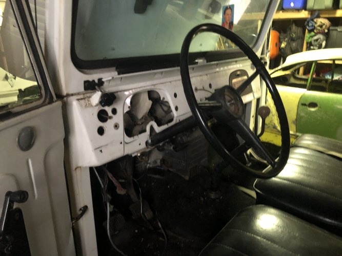

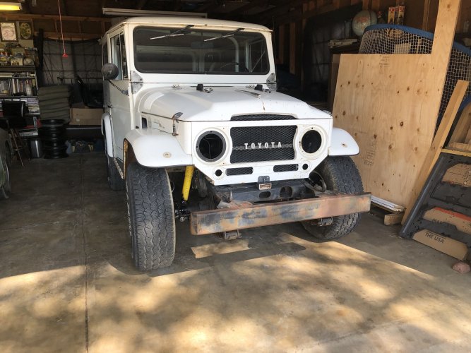

Just a disclaimer: I'm 9 months into this, I've been documenting for myself, but what's the fun in that? (Especially being a member of this forum) To start I initially posted a wtb thread that went like this:
"I’m in the Denver area looking for an entry level fj40. <7500. Not complete rust bucket or crawler build. OG paint/patina is awesome, but ok with rattle can paint sniffing induced “art”. Running preferably or minimal effort required, V8 also fine. Whatever I end up with will be used, maybe even daily(working heat would be a luxury). Anything that comes with history/anecdotes is encouraged as I respect originality, but also expect a workhorse. It won’t be abused, but definitely not pampered. Correct me on any delusions I have, and guidance is also much appreciated"
And I got literally what I was looking for!
Here it is today(what prompted to start a thread as there's a ton more planned for it as well)
I beyond lucked out by having @madorbit as a nearby neighbor to bug with every possible question that arises (as well as random ADD thoughts) who's been insanely helpful getting it going. So here's the first pic: Amazon jeep mirrors that he modified to fit the Fj

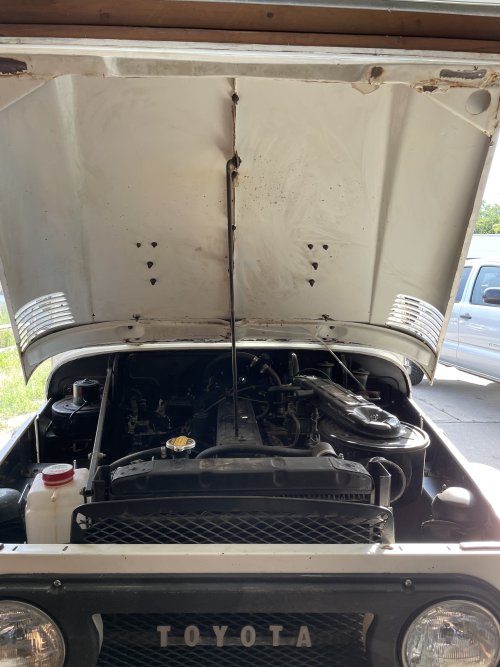

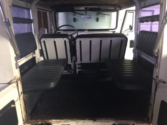

Initial 69 Fj40 Specs:
3rd owner, CO car it's whole life (grand junction)
66,000 rumored miles(speedo fell apart with po)
Og color white with what looks like one respray
Matching doors/hardtop(top and doors removed once summer hit)
F series engine, not believed to be the OG
Converted from tree to floor
A ton of aftermarket og looking mods (to the uninitiated, like aisin big window carb)
Pretty minimal rust
More to come...

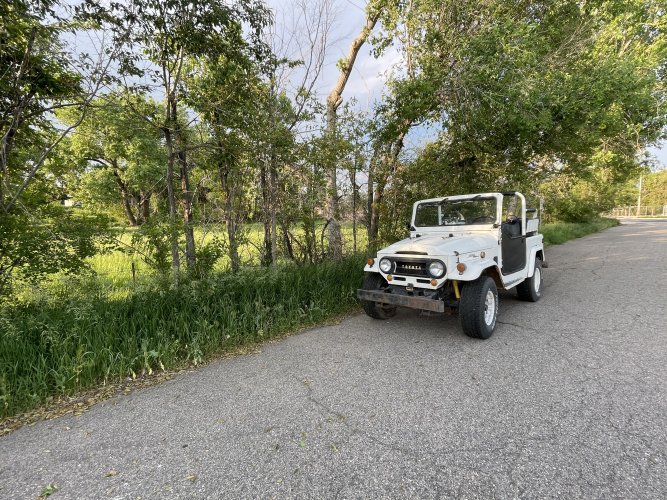

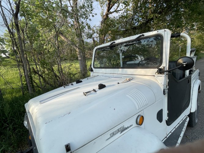

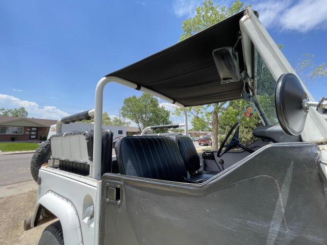

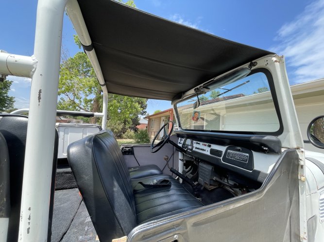

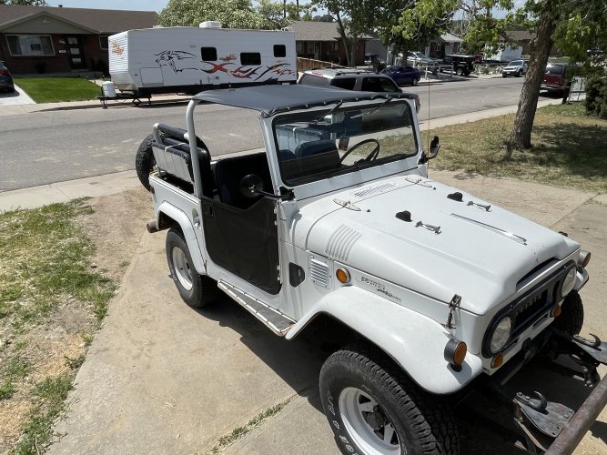

Well I linked up with a buddy of mine from the Vw/Bmx world and we made a bikini top to hide from that sun! So pleased with what he came up with. PO or someone in the Fj 's past had some sort of top installed, used the existing holes and installed snaps Todd at lone wolf whipped together a top... Walla. Gonna shamelessly plug him, he's dialed if ya'll ever need upholstery work
plain simple vinyl for the top double layered with tweed for added structure/rigidity/stretch resistance… And the delightful appearance of having a headliner.
Ironically I'm already eyeing up a full length bikini top, after the addition of a rear roll bar, but it's good to have options! Will backtrack some and add some origins story to have all this started, but was too pumped on the top to keep it to myself.

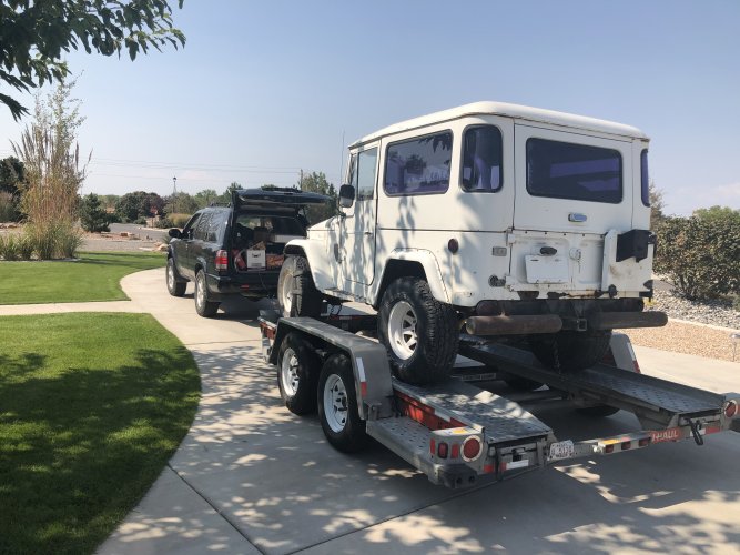

So as promised (to the one or two actually reading this) I brought home the FJ from grand junction to Denver. It was a wild time, had to wait 3 long weeks while the PO had a trip to Moab and I was first in line with "dibs" However, given the affordable price, he had a ton of interested parties, even some trying to come in with the swoop. But he held true and I traversed the jungle to get it home(see picture) JK I towed it home with a rented uhaul trailer and my pathfinder(which later got replaced by a 01 sequoia)

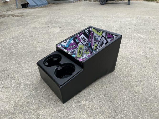

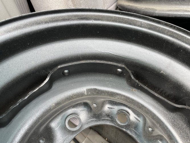

Welp, as I dive deeper into the forty I get more questions. Like how much of this thing is a rarity? When I first got into it I was super confused as to why I couldn't find any information on how to rebuild my carb, come to find out it was a big window and relatively "rare" Not sure how rare is rare. But luckily up the street from me is a landcruiser affectionado @madorbit If not for his kindness the 40 would probably still be sitting haha. Under the hood I found all sorts of random non oem replacements that occurred at some point: oil filter for a scout, o'reilly special fuel filter, welded in trailer tailights(yes welded), aftermarket roll bar that seems into the rear seat supports, heavy duty bumpers...etc I am wondering about the hood, there's a seam down the middle along (just early) with the chrome spear(which I love). Also I scored the custom front brush guard off Craigslist a while back.
Then I also made an armrest, it has a rockin liner fabric...I needed cup holders, and an armrest haha (yes those are pool noodles covering the seat hinges, one bump I hit had me landing on them...painful!)

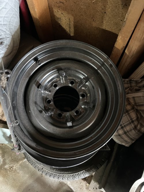

Also I just got some new KO2's on the wheels, thought about going with the Steelies only to confuse my well versed buddy who didn't know what was up with them either, so anyone on here know the deal?

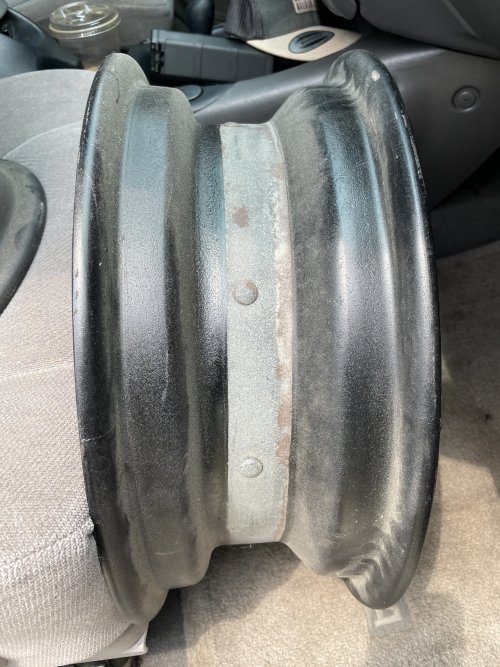

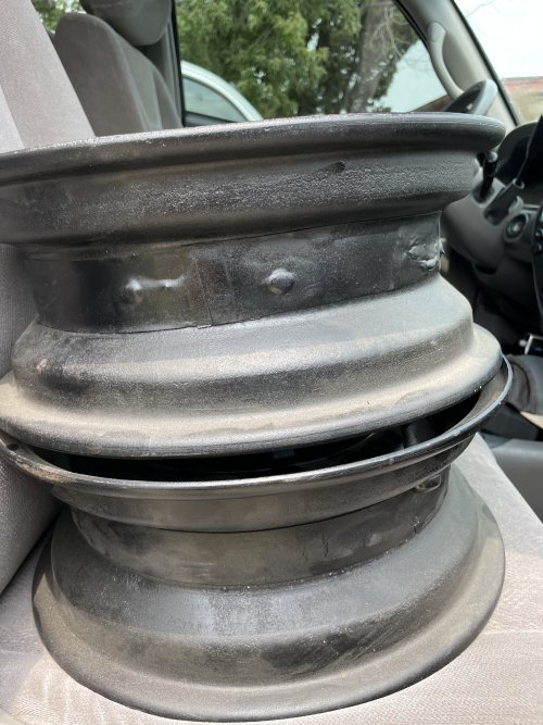

Thank you I appreciate it! I ended up throwing the tires on the white wheels cause I wasn't sure if air would leak on the rivets without the center rubber rim strips. The carb is amazing for when I run out of gas(happened once) just look at it and one less thing to diagnose 🤣

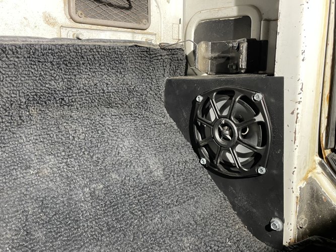

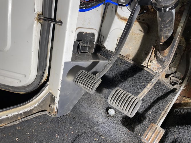

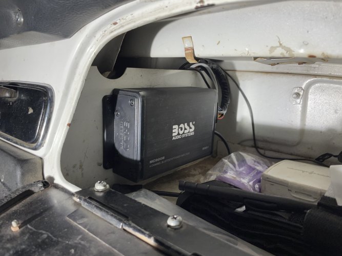

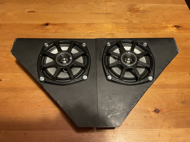

I also decided to take it upon myself to build speaker panels. The online options of $70 and then some didn't appeal to me, especially when I could spend $11 at Home Depot. I've included pictures of the dimensions. I installed a stereo that's meant for a motorcycle but completely hidden in the glove box and bumps! Along with the waterproof kicker speakers, all that's left is the rear speaker configuration yet to be decided.

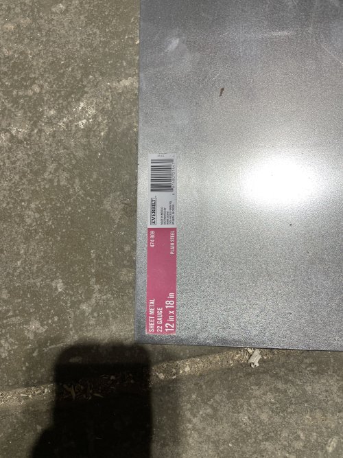

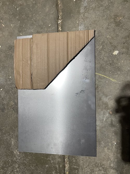

If anyone is interested: the speaker pods are literally one $12 22ga 12x18" sheet. I literally used a builders square, added an inch in each direction...which happened to measure out to exactly 9"=2 from one sheet. Then it perfectly worked out that the additional material provided just enough to make the 90* flaps...obviously cardboard template first, but other wise maybe 3 cuts with tin snips. Only pain part was doing the speaker cut outs. I messed up by placing them too center/rearward and ended up needing to trim 3/8" off the front during final fitting....also my brush guard made a great place to bend the metal. I'm pumped (hence the write up no one asked for).
Also, since no one is asking, the SOR harness is pretty idiot proof. Definitely recommend. Only thing I wish I would've done was mount the fuse box in the engine bay. I almost "started over" and moved it but it would've required extending wires that had already been cut and I didn't want additional variables/fail points. If I had to do it again I'd place the fuse box inside a pelican case right by the heater blower and utilize one of the existing firewall pass throughs...

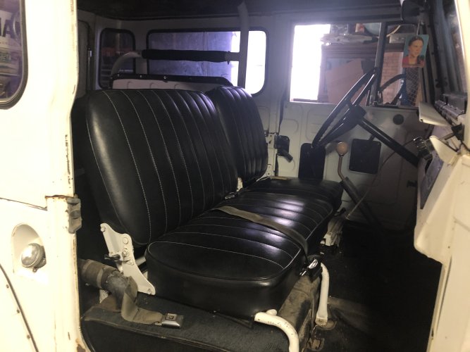

But the big news is I got my front seat redone and it is beautiful! I'm going to plug him every time I get work done as I don't want him to not be able to survive doing upholstery and go back to being a vet tech ha ha selfishly. My friend Todd at Lonewolf upholstery has talent! We just did my driver seat first because the lower portion had a pretty significant tear. But basically, I sent him a bunch of pictures from FJ 45 seats as inspiration, had him throw in heated seat inserts(still need to wire them), and asked him to match my rear jump-seats and Toyota design language. He killed it.
