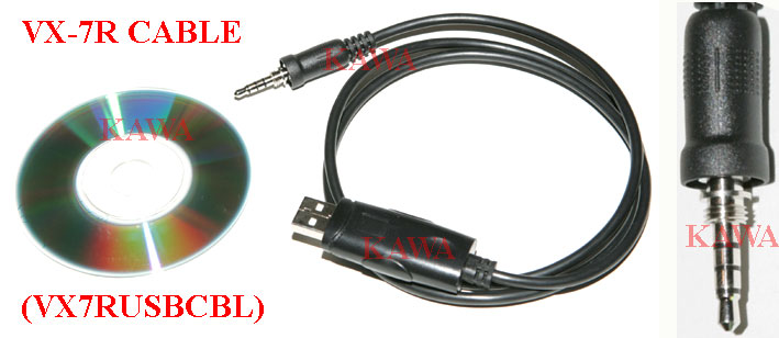

Hmmm...Me thinks I bought the USB cable vs. the serial cable :confused: - I guess I'll have to look...
I have an old laptop as well that I got a WinXP license from Spanky/Sparky/Rudy for :)...I'm betting that sucker doesn't have USB so it will be serial so I should look.
I was planning to set my laptop up to program my 8800 (someday since it is still sitting in the box :o) and tweak the programming on the VX-7R a tad.
Marco, your welcome to borrow it when I get it running...I can bring it to Moab or a future club meeting as well for anyone else that needs to do some programming :thumb:
EDIT: Looks I got myself one of each of these...So if I can get the programming software loaded and working on the laptop I can be your Yaesu programming Huckleberry :hill:
For the VX-7R
