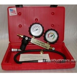

if it truly is a overlaying valve issue you could easilly tell by putting each cylinder at TDC.. i would verify that by looking thought the sparkplug tube's ( i have a bore scope if ya need to borrow) then use this leak down tester (which i also have, and you can also borrow) and if you have air comming out your exhaust or intake.. your timing is off.. and your valves are off .. quick and easy and all you have to do is remove your spark plug and you know were to look.. and you know your timing is off. either by your chain or your vavles are out of adjustment.. if you dont ahve any air then your know its more than likely a fuel issue:thumb::thumb:
