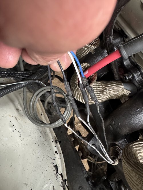

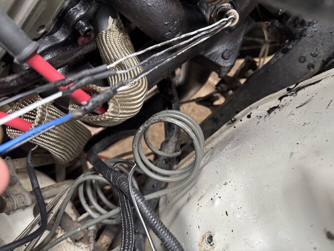

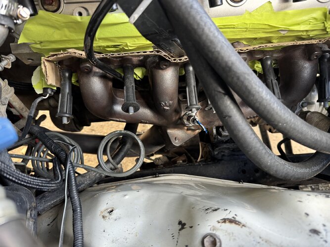

So I cleaned exhaust manifold and pipes, some masking. Painted ( brush) engine in with a VHT flame proof paint (very toxic). Then about 24 hrs later cured per instructions. None of it was easy per my experience. Added new spark wires with heat protection, installed new O2 sensors upstream only as downstream was recently removed at a shop.

Working on adding blanket to it, following reading PP’s post. Will defer from covering the pipes, the most heat I found was at the manifold and pipe junction at about 340-350 degrees after paint, so that point will be covered as well as outside portion of manifolds.
Started and it’s a biscuit.
