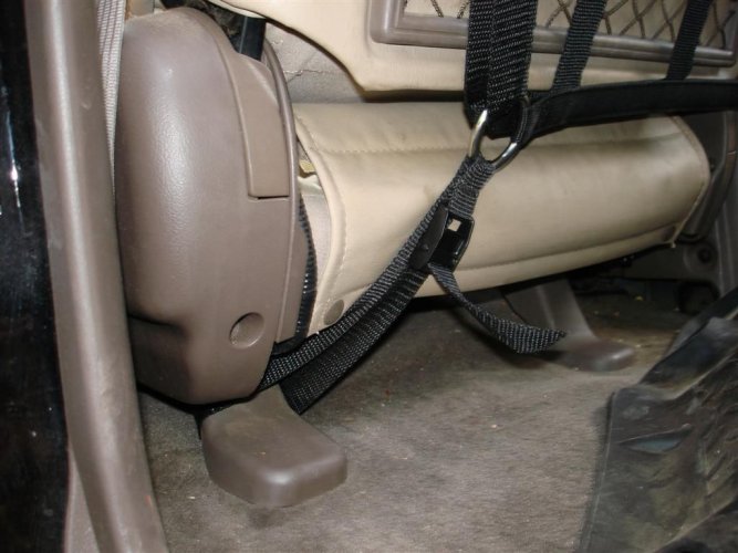

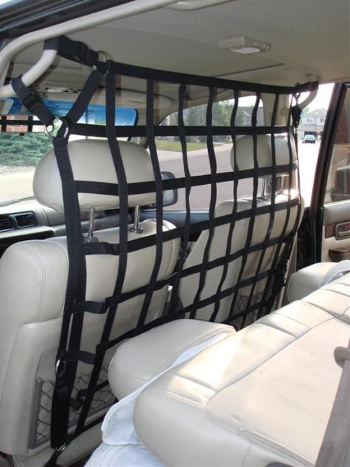

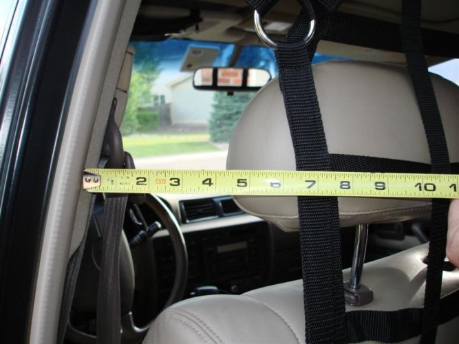

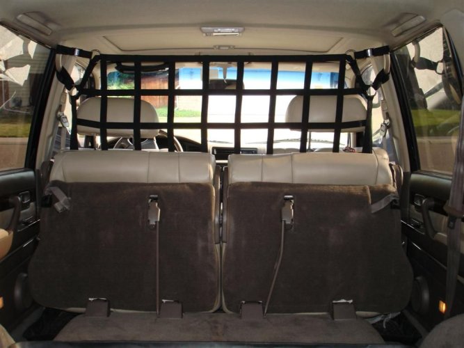

I've been working with Eddie on this for awhile now. Got the net installed and I was pretty happy with it at Moab. I'm working with Eddie to determine if it is a viable solution for the 80 series "as is" or if it needs some tweaking.
What I've found is that for it to really work 100% you'll need to install some footman loops which I am not really wanting to do. I was comfortable though during CM08 with how tight it was how I installed it. I'll throw up some pictures below including a modified version that Eddie sent back to me showing how he thought it should be installed/look. Turns out we "think" I had the top & bottom flipped :doh:. It fits a little tighter now and if I could attach the bottom center to something it would be real taut. Construction quality wise the net seems to be top notch.
On another note, I'm thinking for folks that have drawers OR don't mind installing a set of footman loops on either side that the 1/2 net (IIRC also for the Discovery) would work real well and be all you need. The 2nd row seats of the 80 are pretty high so you don't really need all that much net. The fact that the 1/2 net is less expensive doesn't hurt either. I've been trying to get Eddie to send me on to try out and report back on :D
Do me a favor though. If you DO contact Eddie (Offroad Concepts), let him know you are with Rising Sun and that you are seeing this stuff. I'm not sure he'll give you a discount or anything but I've been telling him I would share this information with all of the RS members etc. so it would be good for him to know we are sort of serious about the nets :). I think how the MUD thread/experience turned out kind of turned him off a tad.

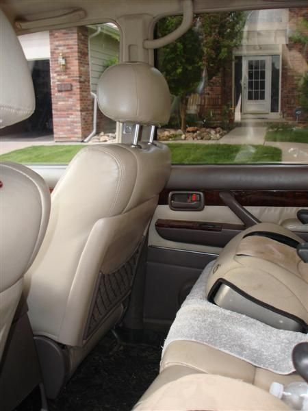

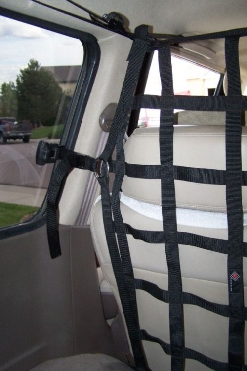

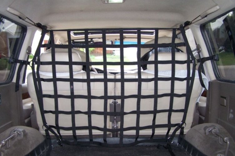

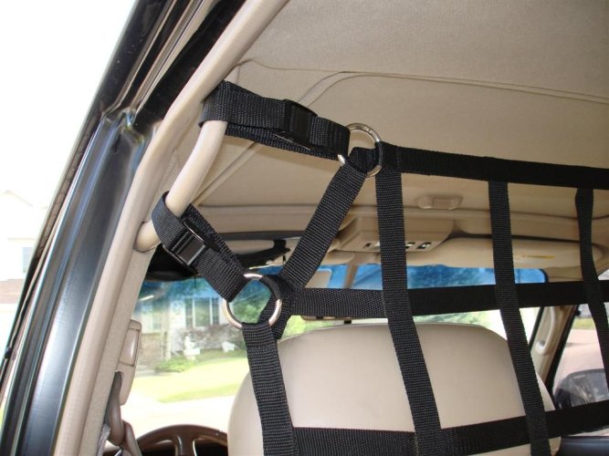

Anyway, sorry for not posting up sooner but I was trying to finalize things a bit more. But, I should have been quicker to share this information knowing that some of you may be interested in getting something for the Rubithon :thumb:.

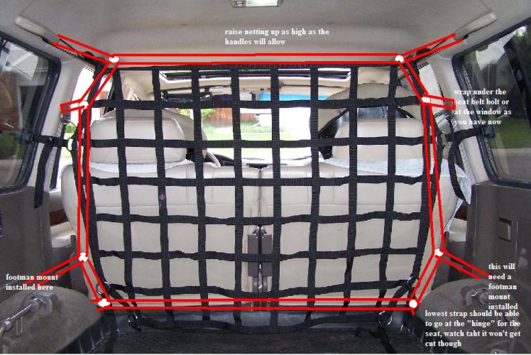

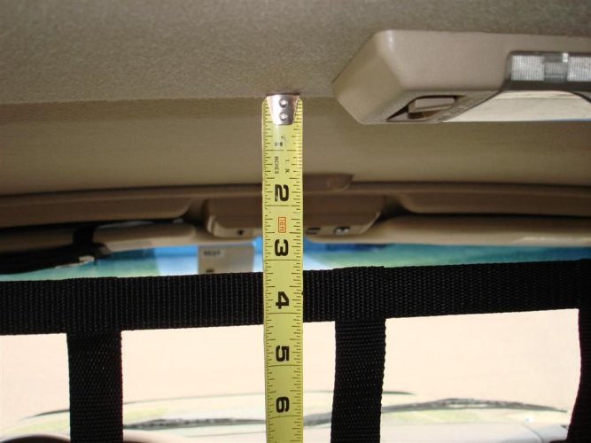

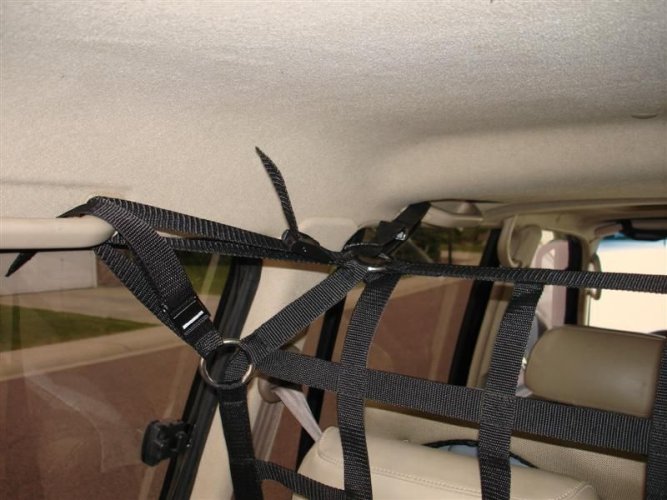

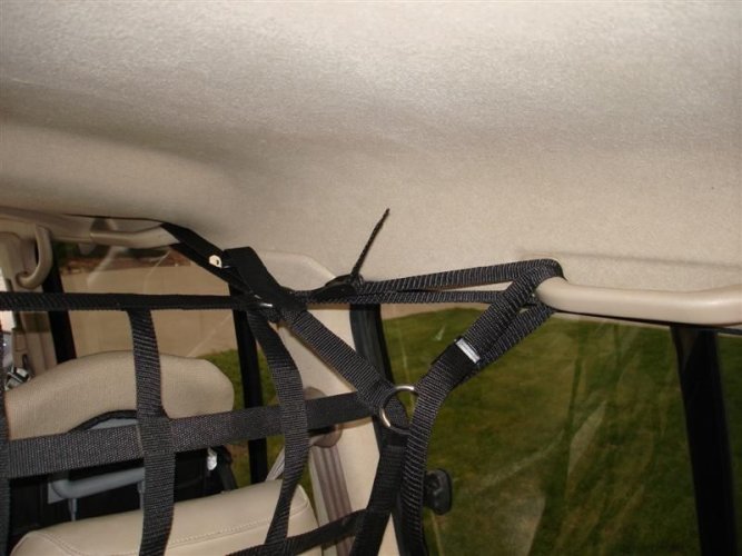

Pics
Picture 1: How I had it installed
Picture 2: Showing how it might look with a couple footman loops to secure the sides of the net (have them temp looped through the 3rd row window latches for the picture)
Picture 3: Showing how I have the top attached - Note I purchased 4 additional sections of tie dows and used one on each side to secure the top of the net to the 2nd row grab handles. Didn't use the other 2 sections (yet)
Picture 4: Just a view of the side

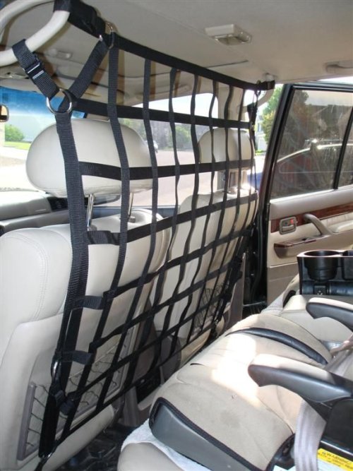

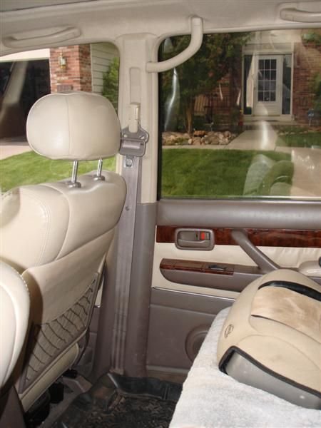

Picture 5: The modded picture Eddie sent back to me - this indicated I had the net installed upside down. I thought the net was the same top to bottom. I reversed the net yesterday and it does indeed seem to fit better but due to the crappy lighting I didn't snap any pictures.

thanks for the pics, that is pretty nice. It looks like the one I want is the D-90 net though, not the Disco one. I really only need a couple feet, just whatever is above the 2nd rows.
Any interest in getting yours Rubithon tested? :) j/k.. these are cool, but dang even the cheapest one is $100.. I shouldn't have waited so long.
edit: what does that middle set of straps hook to? the ones in the slider.. is that just a bracket that wedges in somehow? :confused:
That is my thought (and I believe that is the net Eddie mentioned as a possibility) for anyone running drawers in the rear or that doesn't mind adding some footman loops to the side walls in order to attach the lower portion of the net (I'm guessing here on the install).
Definitely, although I was figuring Matt would be using it in his 80 :D. I haven't talked to him about it though so maybe he already has something to use - either way I'd like to have it on the run to see how it does so I can provide feedback to Eddie. I have one of those metal dog barriers you're welcome to borrow for the trip, just not sure how that would work with your drawers :confused:.
There are actually 4 attachment points on each side...The loops at the top and bottom and then another set just below the top loops and just above the bottom loops. Technically the preferred installation method would be to install 4 footman loops on each side, at strategically placed locations, for the straps on the net to attach to.
Personally, I don't really want to drill into my body to attach the footman loops to the truck, so I'm trying to make the net work without doing so. I have now attached both upper sets of straps to the 3rd row grab bar (in the second picture above I have 2nd top strap temporarily strapped to the 3rd window catch plate just to show what it would look like with that strap pulled tight out to the side). I then used a couple of the additional straps I bought to attach the top loop to the 2nd row grab bar as well (one per side). This allowed me to "center" the net between the two and have it hanging just behind the 2nd row seats.
For the bottom hoops, I only attached one of them on each side to the cargo tie down points. I wasn't planning on the net having to hold anything heavy back as the heavy stuff was independently strapped to the floor for CM08. I really wanted the net more to keep lighter items like sleeping bags, duffle bag with clothes, pillows, etc. from coming forward.
Now that I have flipped the net (top became bottom and the bottom became the top) like it should have been it seems the net appears to fit better and more like what Eddie drew up on that picture. I have the 2nd loops from the bottom attached to the hinges on the outside of the second row seats and the bottom loop attached to the cargo tie down points. Much tighter now.
For the full net setup I'm thinking that it might work if a person were to fab up some brackets that could attach to the grab handle bar bolts that would allow you to slip the strap through. Make up a couple more that could attach to the 2nd row shoulder belt attachment point for the 2nd set of straps. Maybe install 1 set of footman loops on the wheel wells for the 2nd from the bottom strap. The bottom strap would still attach to the cargo tie down points.
For the 1/2 net the setup would be the same at the top but the bottom would need to probably have some footman loops on the side walls of the rig. The question being how low would those loops have to be to make the net tight because I can forsee problems if the loops need to be installed down where the interior trim becomes the bulky plastic....

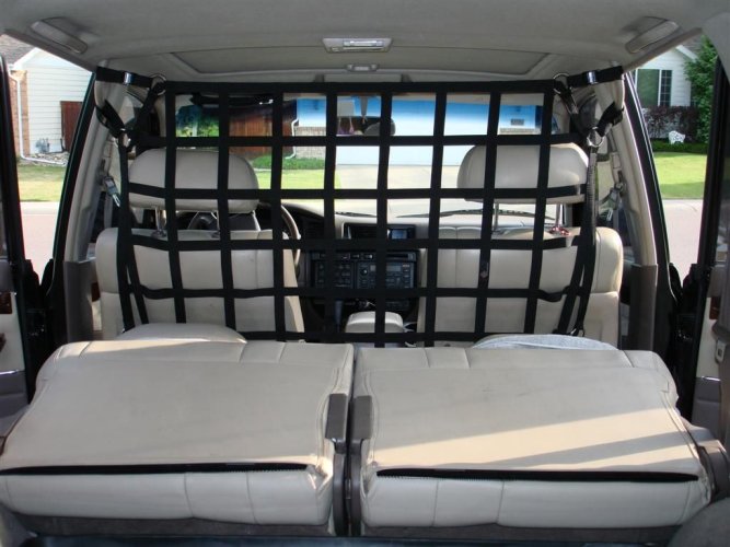

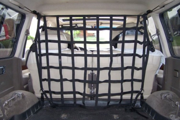

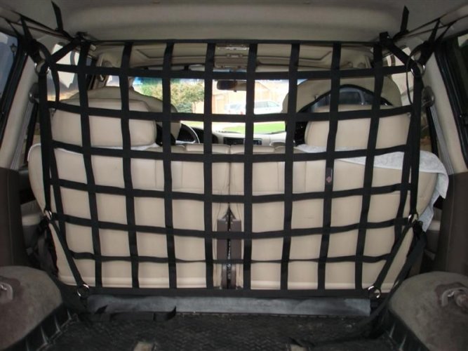

New pictures...
Got the net "flipped" and it seems to fit much better :rolleyes:. All I can say is I was in hurry mode to make CM08 and was just happy to get the net installed for the trip and never bothered to pay much attention to something as trivial as there possibly being a top and bottom to the net :hill:
Anyway, here are the pics and you can decide for yourselves. For my purposes the net works fine. My one comment is it might be a couple inches too long but my feeling could change if I were to install some footman loops and really get it pulled snug side to side. But, I'm thinking rather than installing footman loops I might look into having some attachment points fabbed up that can be installed under the grab handles and seat belt attachment points...
NOTE: The way I have the net currently installed required the use of 4 additional straps (purchased with the net). 2 are used on the top loop to go from the loop on the net to the 2nd row seat grab bars (allows me to "center" the net behind the seats). The other 2 I used to lengthen the straps that are attached to the net loops I have secured to the 2nd row seat side hinges (can be seen in the 5th picture - note the two buckles).

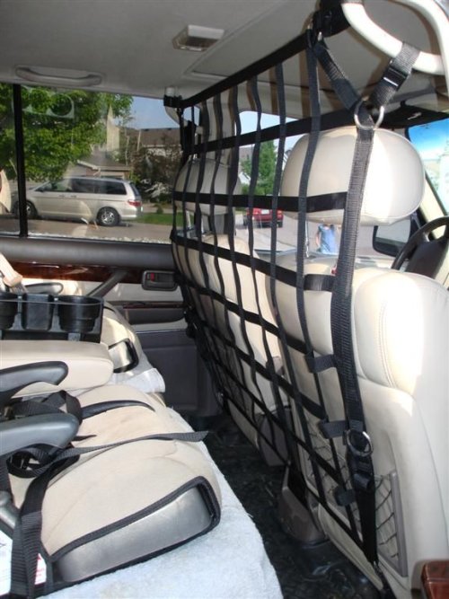

Pretty pleased right now :D - Moved the cargo net from behind the second row seats to behind the front row seats. I attached the top 2 straps to the front 2nd row grab handles and I attached the bottom strap to the rear of the outside front seat frame. I just looped the 2nd strap up from the bottom to the ring of the bottom strap. A creative person could fab up an attachment point coming off the front seat belt lower mount and/or the seat frame bolt for the bottom straps if they desired.
In the pictures, both front seats are set to where they are normally positioned. Both seats can slide/move forward without any strap interference. I didn't really check for rearward movement but I imagine that would just make the net tighter.
I took pictures with the 2nd row seats up, folded flat, and tumbled. Also, I took some pics with a tape measure to show how much space there is from the top of the net to the headliner and between the side of the net and the B pillar. Nothing big should be sneaking through there. Now, if you carry a samurai sword or something similar, well...:rolleyes: :lmao:
Anyway, check out the pictures and let me know what you think. I'll have the LX at the meeting on Wednesday night with the net in this configuration (I want to check for "noise" from the net movement, if any).
