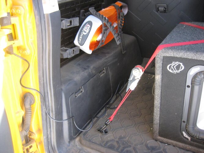

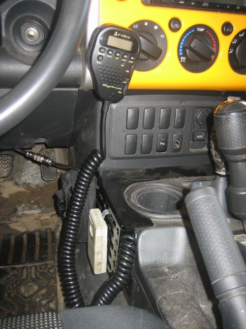

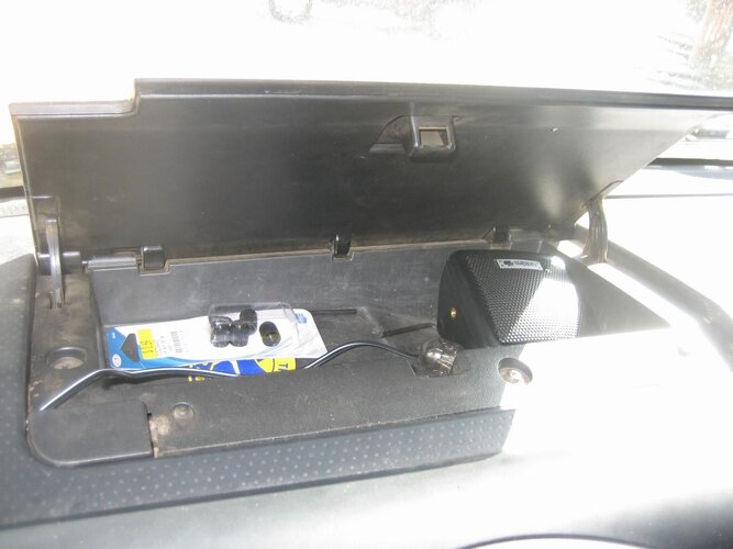

I'm going to clean it up a little bit including hiding this wire in the back cargo but as it goes right now I don't allow any cargo in the back, and the side the wire is on is the side my speaker wire connects(sub). I found that the speaker for the CB can fit in the area built for the navigation in front of the steering wheel, and it will close. And then found a way to hide the CB wire under my M-PAC thingy (I can't remember what it's called) and that help keep cord from dangling in front of my feet.

If you haven't already done so, I'd zip tie that coax above your pedal out of the way :)
Did you have to use a coax extension to reach all the way to the front? If so, make sure you don't "loop" the excess up in a circle shape...Make it a figure 8 with a zip tie in the middle.

It looks a lot worse than it is, and I'm going to be getting a shorter coax cable because I have a lot of excess. And now that I think about it I'll go measure it and guesstimate if the shorter fire stick cable will work. When it's complete I'll either have the cable connect for the cb coming out of the spot where the speaker is now or have it coming out of the notch above where the connect is above the gas peddle in the pic.
