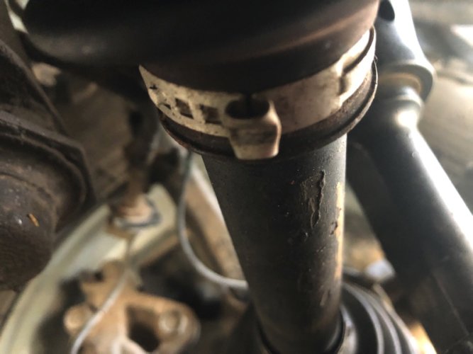

Going back and watching videos, I think maybe the problem here is I dont actually have OEM axles in the first place. The OEM ones are slightly thicker where the boot clamps on and have grooves in them that mine doesn't have, so that might explain why the OEM boot doesn't quite fit.

How much do you want for them? I may have found a way to make the one I have work but need to try something and see. I know the OEM ones are better in general anyway.
I was hoping this would be a short job, but it's looking like I need to replace the dust seal in the axle hub too since it sort of fell apart when I pulled the axle out, so I'll need to track down that part too.

I didn't see this message before, im not doing the boot stretch thing, it has an inch or two lift but nothing to make me worried about that upper boot. The lower one was close to cracking on the old axle which is what started all of this.
I made the reboot kit fit through the use of bits of rubber tubing and some hose clamps. Its ugly but mostly holding so far.

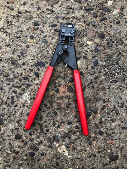

My neighbor had a few of the OEM clamps and he said he was able to just use an old school PEX clamp tool. Which if it works is hilarious.
I have one of those pex clamp tools as well, so we could see if the clamp is the right size or if he was pulling my leg.
14,148
Let's put some of this to rest.

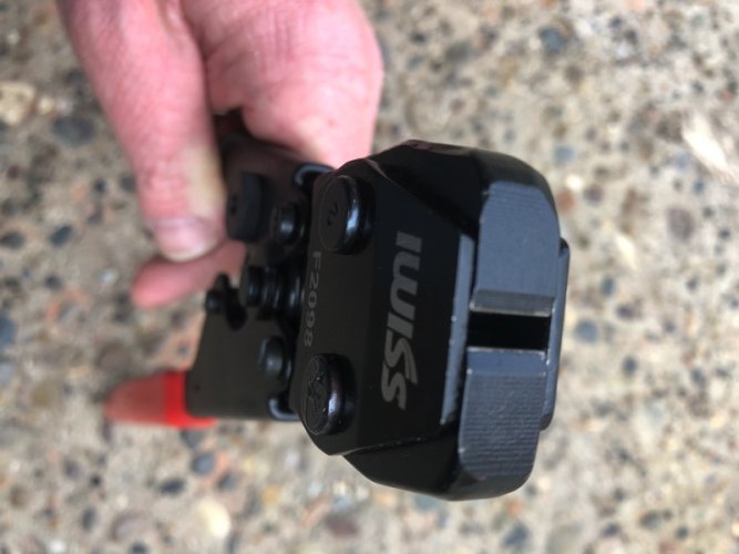

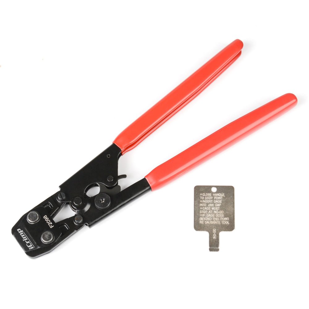

This is the tool I use to crimp my OEM CV boot clamps.
Iwiss F2098/KG1096
It's designed to crimp PEX and can be calibrated to do those right. Which is fairly important since the connection is supposed to achieve a 50-year life and you don't want your water lines leaking.
