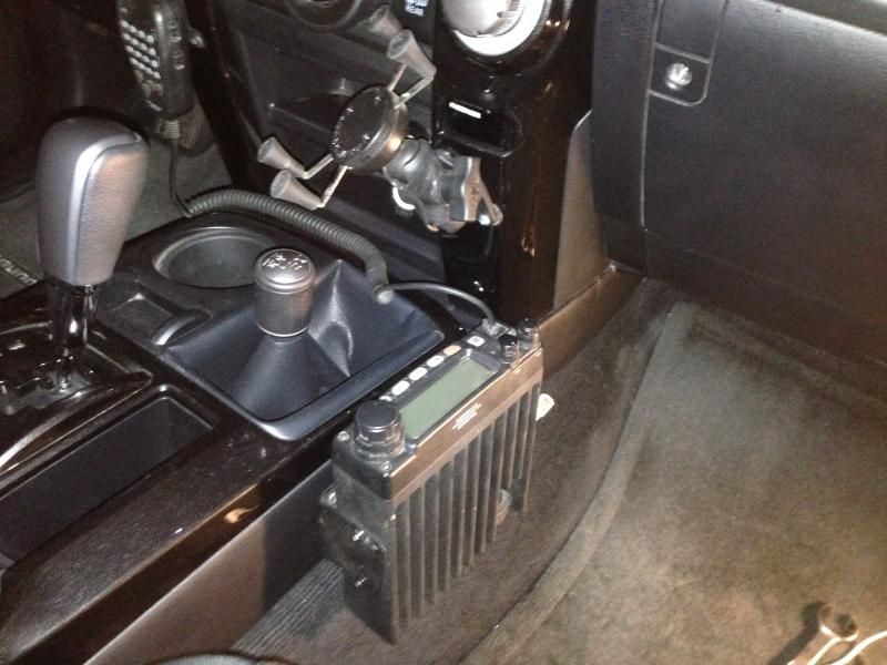

couple 4Runner pics, this where my CB is in the 100:

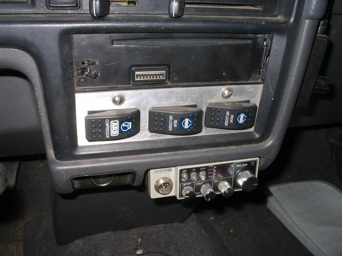

This setup is pretty clean though, IMO.. I like how he filled the gap with a USB port (probably for the stereo)

Perhaps you could utilize the ashtray for a CB. The Uniden Pro 510XL, 520XL and their older cousin the PC55 that I have fit very nicely there. You just remove the ashtray and the bracket, which is held in place with just a couple of screws and figure out a creative way to hold it. I was able to return the ash tray into service after removing the CB in preparation for selling my truck.

Here is what I've got now. I quite like the CB radio I have but I guess I could be convinced to switch to one of those tiny CB radios that would fit in the ash tray hole...
Let me tell you though... it was a real pain to squeeze this CB in where it is. I would hate to remove it now just because of all the work I'd be losing. :hill:
14,132
I think the question is how much you want to cut up your dash. The ash tray slot will accommodate a radio about 4.5" wide x 1.5" tall x 6" deep. Units such as the Uniden fit pretty well there and the only real compromise was I needed to run a right angle PL259/SO239 adapter. To fit a ham radio there would mean hacking up things, even the very small FT-1900 is 6" wide and the FT-2900 is another 1/2" wider, 1/2" taller and 1.25" deeper. A DIN slot is 7.125" wide by 2.125" tall, which is why ham radios fit so well. Your Uniden is a nice CB, but OTOH why not take advantage of the collective trials and errors of what other people have done?
