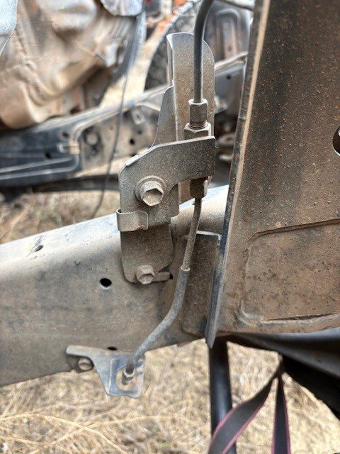

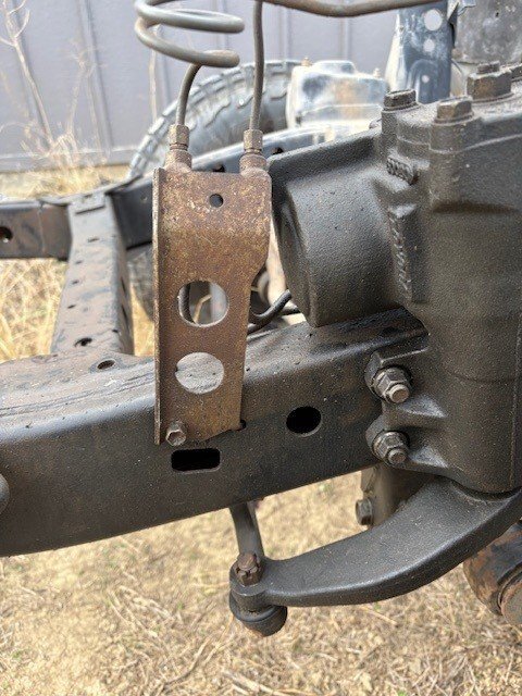

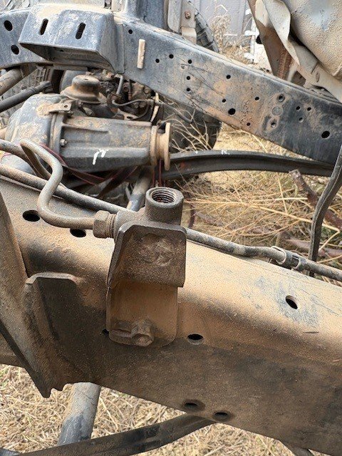

Daniel are any of these the brackets you need? On a 97 Chassis.
Mike - thank you, no. Very thoughtful of you to write. The bracket at issue is welded to the structure supporting the right side spring perch.
It is visible in the very center of this photo you posted. You can see the hard line enter from left and hose exit right. I have this bracket. I have to fabricate its attachment to the axle housing. Meeting my welder this afternoon.
