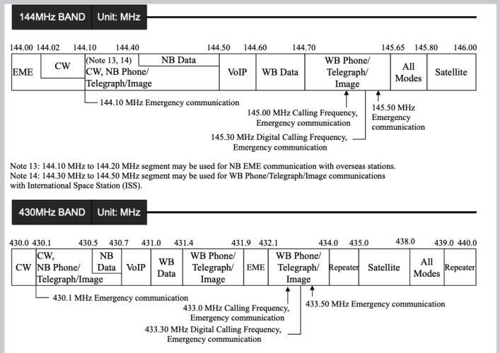

Not sure if you noticed but that one is in Tokyo and just says the FTM-400XD, but doesn't say the U.S. model number. I don't know the bands in Japan to tell anymore but you'd probably want to make sure it works on our bands here. Yaesu puts an 'R' at the end of the U.S. models, so it would be FTM-4000XDR here. If you see an 'E' I think that is, clever enough, a European model (e.g. FTM-400XDE). I've also see 'H' as trailing, not sure 'bout those, but may be the Japanese market.
Edit to add. Japan is IARU region 3 and JARL is their coordinating body, so their band plan for 2m and 70cm looks like this.

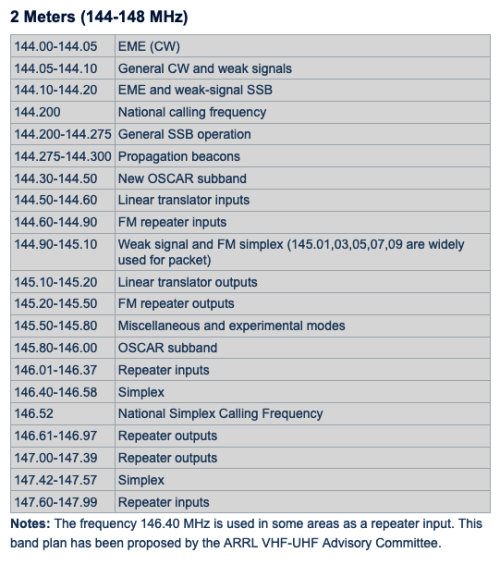

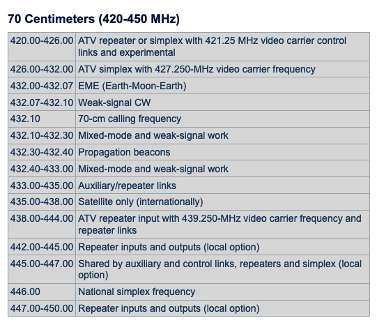

I know everyone remembers their license test. The U.S. is 144 to 148MHz on 2m and 420 to 450 MHz on 70cm. What would be important though is knowing where the FM simplex and repeaters are located if you want the radio's automatic mode selection thing to work right.

well nevermind then, maybe there isn't one on ebay :/
15,195
yeah great comment Dave, thanks. the search continues...
