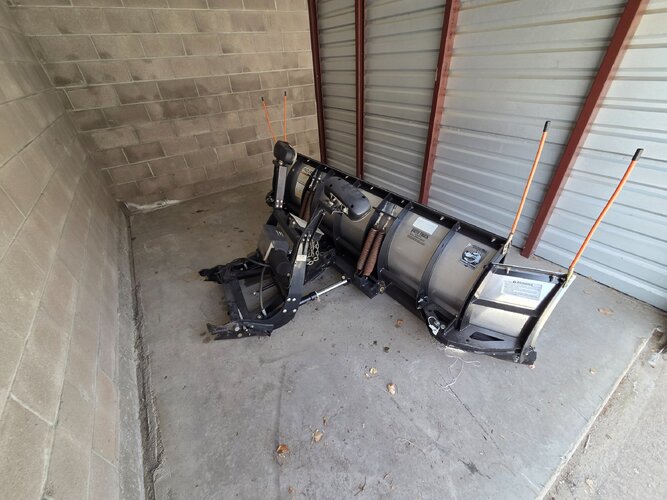

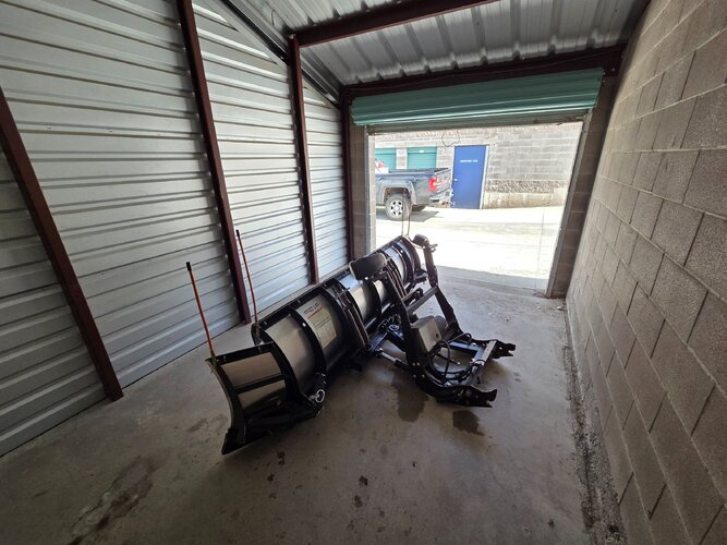

Bummer. This snow plow I got is bigger than what I thought it would be, and its really heavy I was going to try to get it in the bed of my truck by myself but that's not going to happen lol. Unless you're bored and think we can get it into the bed of my truck?

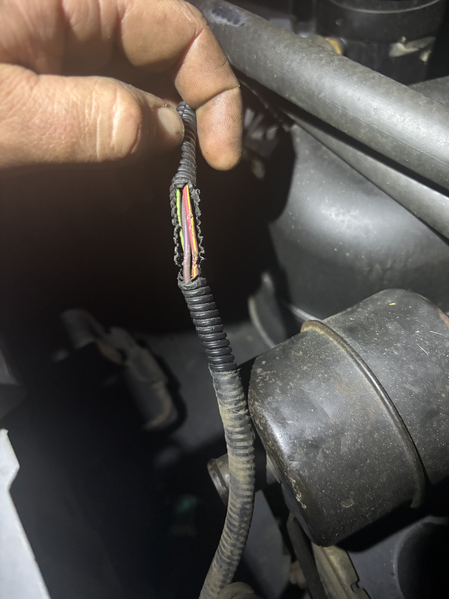

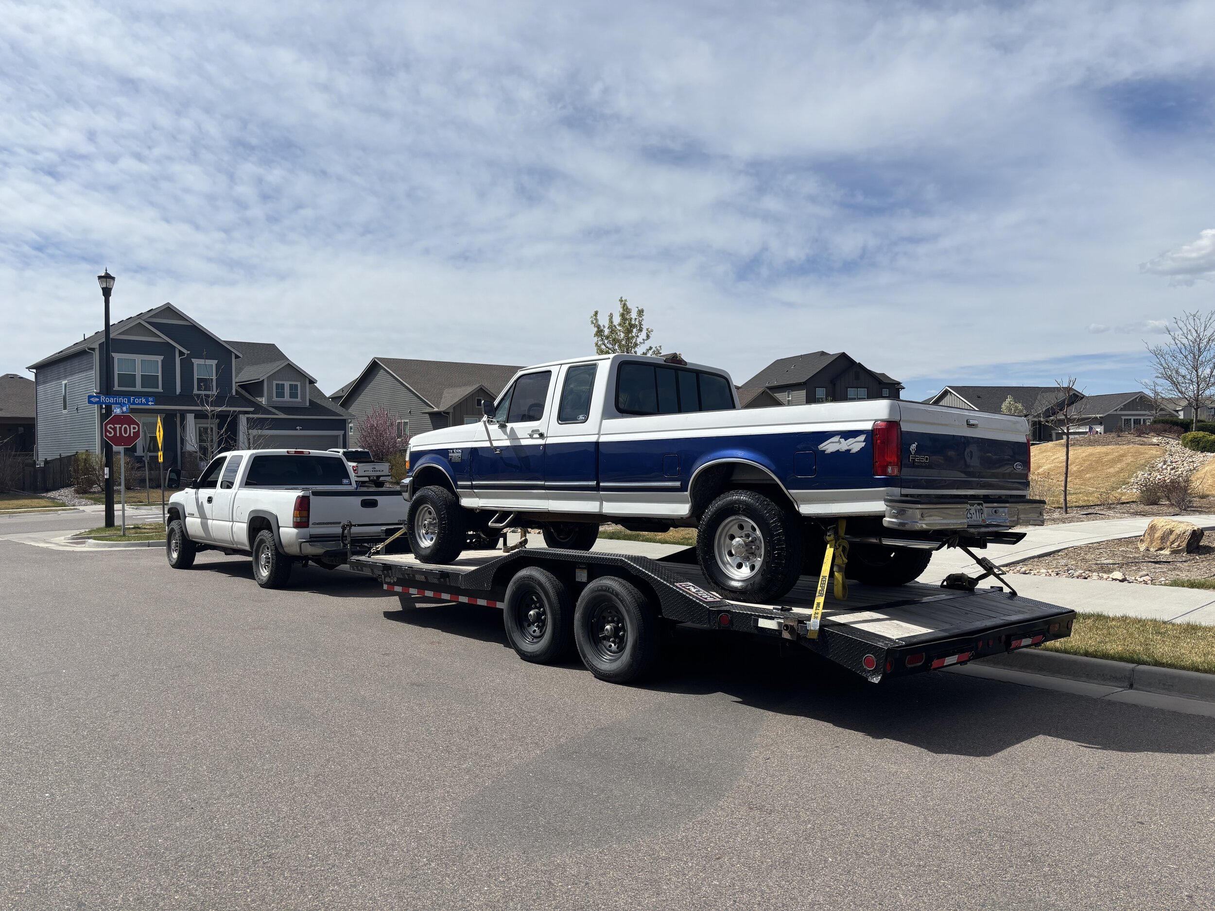

Well I had a wild weekend. Drove from Longmont to the springs to look at a 7.3, and then back up to Brighton to look at a 460/zf5 truck. I bought the 460 truck, loaded it up and headed out Sunday afternoon. Overheated the Chevy 8.1 on 287 near the Forks bar. Blew a heater line and dumped four gallons of coolant. Took 460 truck off the trailer and drove it to town for the parts. 460 idled rough, was throwing CEL. Pulled code, was for MAP sensor. Replaced MAP sensor. Idled better, but fell on its face when accelerating. Traced wires, found a place where a mouse at the wires. Cut and spliced, replaced serpentine belts while I was at it. Ran great after that. That was at about 10PM. Got a coolant cap, hose, fan clutch, and coolant for the 8.1. Got that truck fixed just after midnight. Drove two hours and slept at a DOT turnout near Elk Mountain at about 2 AM. Woke up at 8, drove home. Now I’m gonna shower my nasty ass off and mess with the 460 truck.

The truck is a 1997, three owners, one of the owners was the seller’s friend. 460 was rebuilt with an RV cam about 50k ago. No oil anywhere, and just a few drops of coolant. Everything is tight except for the front D shaft and the drag link. Clean inside and out. Tires are decent tread, but dry rotted. One rear pass side middle leaf is broken. I’ll probably just rebuild the rears with an add a leaf. Best part was I talked him down from $8000 to $5000. He threw in a water pump, train horn (anyone want to buy it?), and an OBD 1 scan tool.
