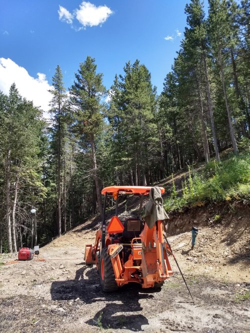

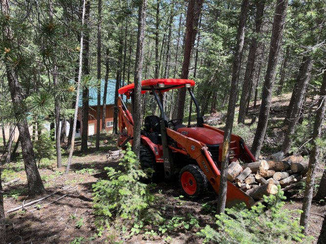

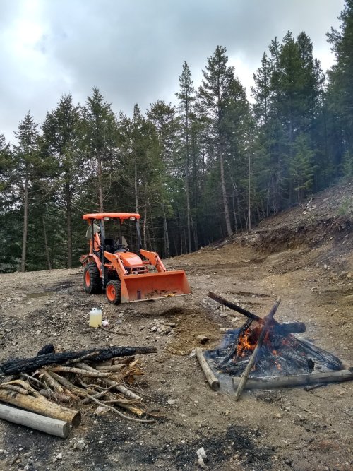

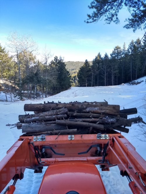

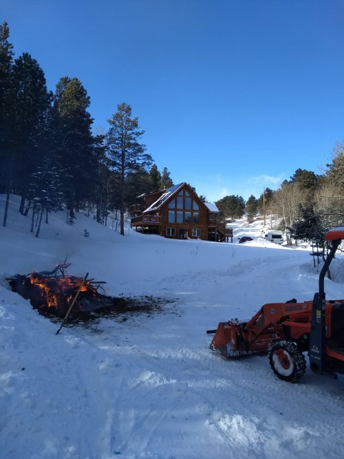

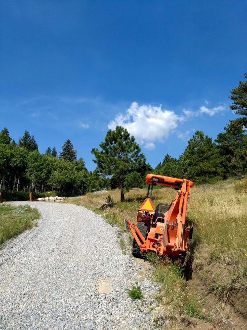

Yeah, the BH is super useful. It cleared the land for the shop which required digging into granite, clearing drainage, cleared the lower property and shooting range. I'm currently cutting a walking path around our property but, that's a multi-year project as I get to it. Best money we ever spent considering the cost of hiring a contractor to do the same
work.
