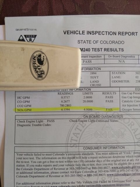

Hello all,
Just got back from the primate panorama over at the emissions place on 44th.
I passed everything but the NOx (4.0 is limit, I came in at 5.3xxx)
Normally, I would just pour some denatured alcohol in an 1/8th of a tank and retest.
But now since reading here and in mud, I see EGR , o2 sensor, or cats may all be culprit s.
I wanted to get a feel for where the truck was without any "emissions trickery" first, then once I had some numbers to work with, dial it in from there.
Tires were full of air, 1/2 tank of 85 octane(now that I think of it, this gas tank full probably had Techron fuel system cleaner in it... Possible cause for fail?).
Since I guess I'm looking for some thoughts on how best to proceed here. Based on the readout from the inspection report, (attached) what should be next steps for me here?
Still reading up on these issues here and elsewhere, but given the relative "closeness" of a pass on NOx , I wondered if there were a tip or trick or some thing I can do to pass before tearing into EGR/o2/cats.....any thoughts?

Based on looking at your limits from your test report I am assuming that you have a 94 80 series? I was having the same issues as you. First double check your timing and make sure that you are at 3º BTDC or at factory settings. Second I know it may sound like snake oil but try using a bottle of CATACLEAN. Its about 27 bucks from the auto store but still better than buying a new cat. This stuff works. I was very skeptical about using it but my numbers dropped by about 1.5 to get me to pass on my NOx numbers.

Your CO2 is high and the CO is low so I think the cat is doing its job. I'd dig into the EGR to see if it is plugged up with carbon.

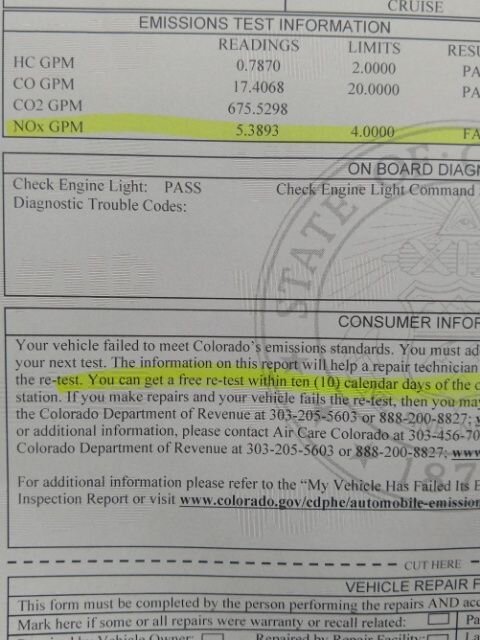

Ugh...still no joy on the retest.
Heet red bottle in 1/2 tank of Conoco's finest.
Tires over inflated.
Drive to Dacono testing like a Mumbai taxi driver.
All other gasses seemed to have come down.(see attached) NOx slightly UP from initial failed test.
I guess I'm needing to pull the EGR valve and figure out if it's needing to be cleaned? EGR Module replaced?
I am in uncharted waters here. I've never had to dig in to an emissions system any more than mixing up a fuel cocktail.
Thoughts? Advice? Resources for going through the EGR?

Obliviously your not throwing a CEL right? You shouldn't have to completely remove the EGR. I would pull the EGR temp sensor and clean it. It may be covered with carbon. Once you pull the sensor, If you have a small wire brush that can fit inside of the opening you could spray some EGR cleaner in there and brush it out. Make sure all of your hoses going to the EGR are in good shape as well. Like I said try some CATACLEAN. It got my NOx numbers down.

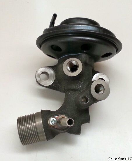

The temp sensor is located on the passenger side of the EGR body. I believe it's a 14mm wrench if memory serves me right. In the photo it is the port directly below the diaphragm.
