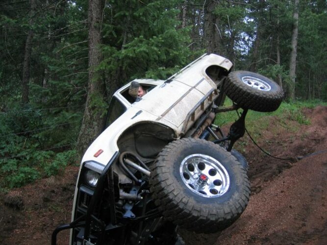

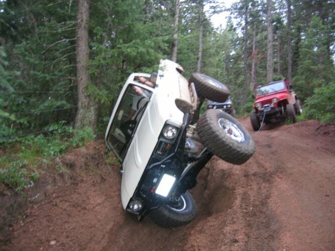

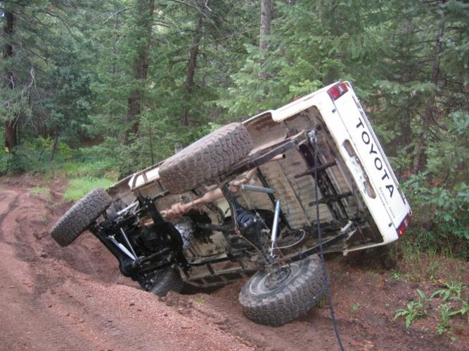

Got some wheelin in
The bank gave way a bit and ended up in this spot...oops
Overall the truck runs good now that I put the new Fuel Pump in. The rear springs are really stiff and don't flex like I want them too though.

corsair23
Jul 11, 2006
8,610
:eek:
Glad to see you got the rig out though :thumb:
As for the rear springs, load up the bed with weight (sand bags, whatever) for awhile...That should break them in quicker and hopefully improve your flex a bit.
jacdaw
Jan 29, 2009
1,229
:eek:Yikes Mark! Cool heads prevail in situations like this. Glad you got out without serious consequence. As for your rear springs, I went back through your photos and can't really tell, but how many leaves? Are there enough that you could pull one and relocate the shackles while still maintaining payload?
May 20, 2009
38
Castle Rock
I was thinking the same thing John. They have 8 leafs in those rear Marlin packs. They are not thin leafs like factory, so I assume that I could remove 1 or two. I never plan on really hauling anything in the bed except maybe my ATV that weighs 350lbs.
If that doesn't work I'm seriously considering linking the rear. Looks like a 3 link would work with some soft coil springs.
